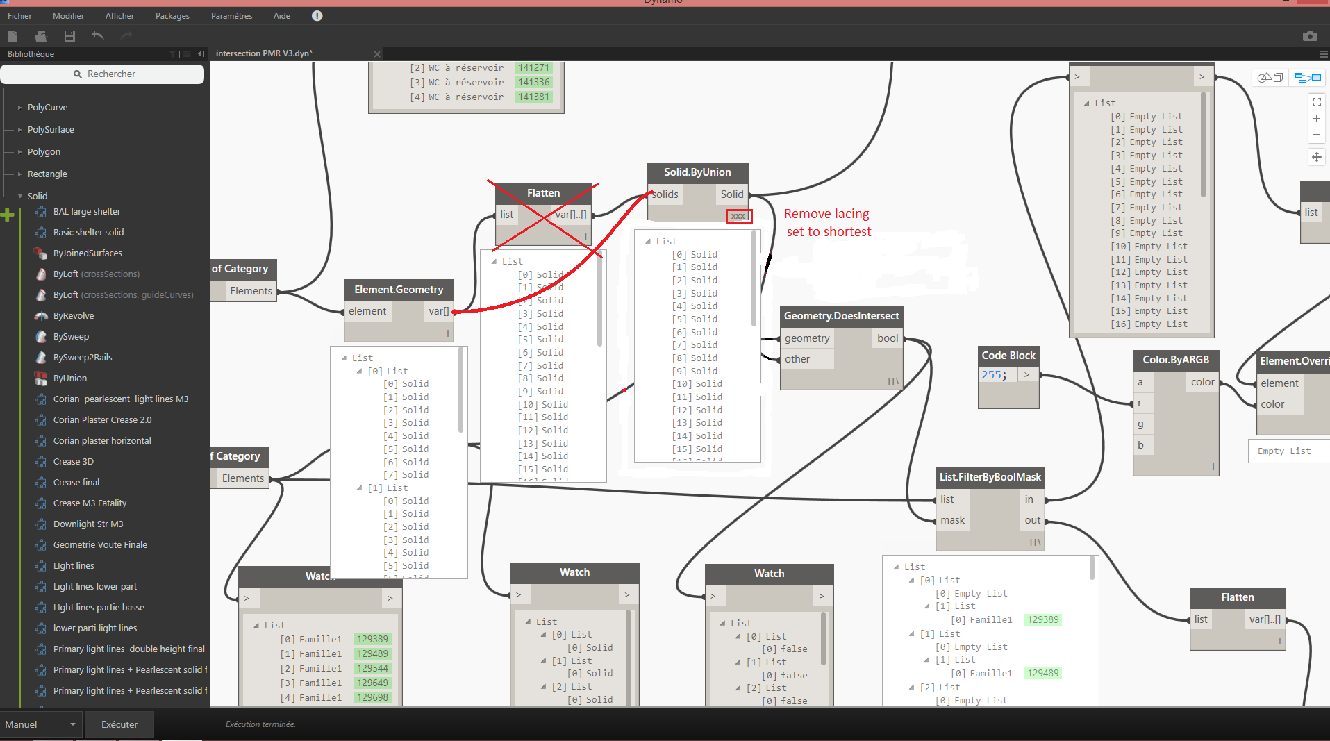

Hi, I have a list containing multiple solid , I want to combine them to a one solid , I used the node solid.by union , but it doesn’t work , I tried to change the combination , but unfortunately that’s not working . any help please
Could you drop your dummy rvt file here? What are the elements and category?

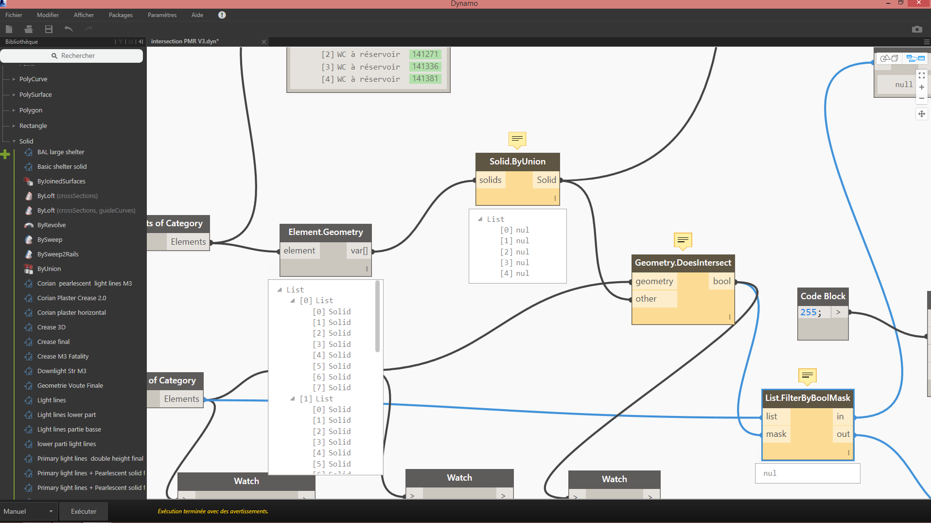

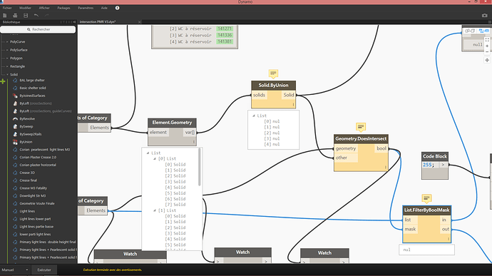

I tried to verify if a family is intersected with some categories like wall and plumbing categories , it works perfectly with walls category but not with the plumbing .
Dynamo file :
intersection PMR V2.dyn (14.0 KB)
Revit file :
it’s working fine with the wall category but not with plumbing category , I use the last version 1.1
I have same problem. Solid union create more than one solid.
