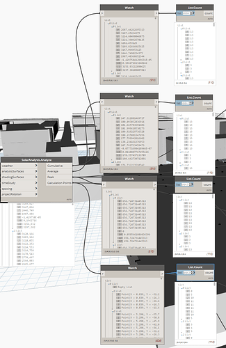

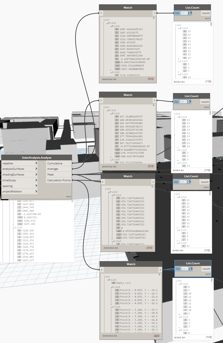

SolarAnalysis.Analyze node - lists not matching
Continuing the discussion from Solar Analysis node issue:
3-4 years later Im having the same problem as Negar.s, it probably has something to do with the node discarding the UV points outside of the surface but not discarding its Peak Avg and Cumulative values.
it only happens to non rectangular Surfaces.
I Suppose the only way to fix this is if the DynamoTeam fixes the node.
Thanks for reporting the issue. We are working on this issue and hopefully the next version of package that is being released soon will address this issue and a few others reported bugs.
If you look at the values radiation is the same at least when using a box, what i did was counting and taking the same number of elements then all lists matches Hope it helps
I’m doing solar analysis on an irregular surface and I’m facing the same issue as you. I hope the development team will fix this bug.
