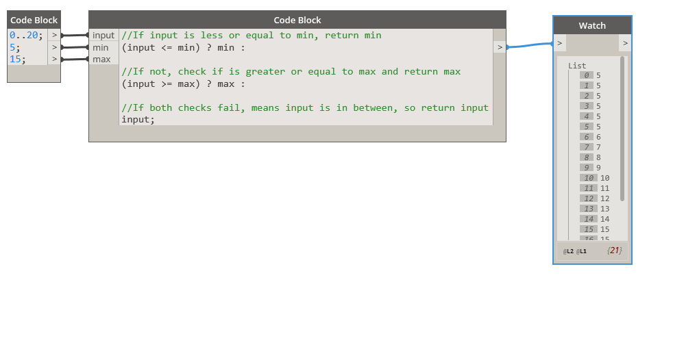

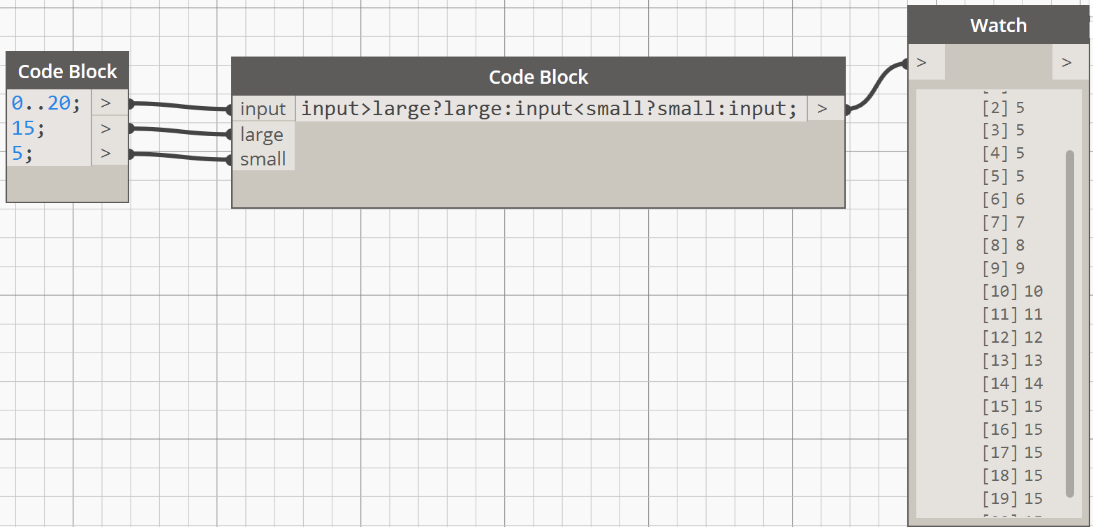

Regardless of what is the end use of the values, @PauLtus 's method gives the output you said you are looking for
Broken down for better understanding:
