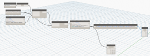

I can’t figure out why the sizes over 89 doesn’t come out with 50?? (thouse marked with red)

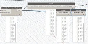

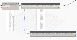

But it didn’t solve my situation.If I added a code block before the Formula the result where right.
It is like if the number is over 100 then it starts from the beginning again!!
I don’t know if it could be because it’s with 3 numbers?? (a guess)

As you can see it does not work. I’ve added your suggestions. But Thanks for the try

I have tried with a more simple formula, 2 times with different values… I think now that it could be something with my units??? or??
It seems to be considering only the first two digits.

The issue for Dynamo is that the size number are redden as text and therefore you need to change it to a number. In the attached file, you will be able to see how we have splinted up the text list and converted into numbers.

guys i followed your discussion and suppose that the problem lies again in dynamos’ / revits’ unit conversion capabilities.
you guys are most propably working in millimeters but still (0.82xx) dynamo extracts inches.
as you can see when transferred from millimeters to inches and back the result is correct even for values >100

I’ve solved my problem with putting in the box “String.ToNumber” before the formula.
