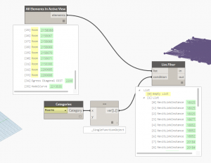

Hi all,
why this is not working?
Thank you!
Hi all,
Thank you!

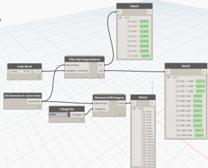

Hi Giovanni,
The “==” node is best used to compare numbers, strings and Boolean values. If you want to see if an element belongs to a category, you could try the “Element.IsOfCategory” node from the clockwork package. The “Filter.ByCategoryName” node from spring nodes will directly filter out certain items for you based on their Revit category name:
