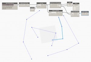

The clockwork package has a node called “PointSequences.ShortestPath” that is similar in concept.
Does this work by calculating the lengths of all lines and returning the shortest or will it use a combination of them (segments of them) to give you the shortest route from point A to point B do you know?
You’ll have to create the "paths "yourself unfortunately. It will tell you which path is the shortest.
Matthew, I also made a node for creating paths (e.g. based on door locations) but haven’t migrated it to Dynamo 0.7.x yet (here’s why: https://github.com/CAAD-RWTH/ClockworkForDynamo/issues/17). You can find a sample workflow here (but you’ll need Dynamo 0.6.3 and the Clockwork 0.6.3 package to run it):

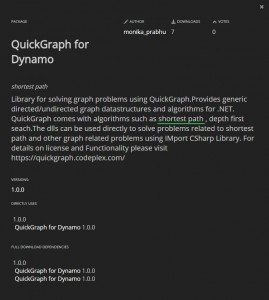

Noticed this on the Package Manager, haven’t tried it though
Hello All,
We have recently uploaded this package.
If you have any questions or if anything doesn’t work for you, please let me know.
Thanks,
Ritesh
Thanks I’ll check it out. There are actually 2 versions on the Package manager, both v1.0.0. I assume they are both the same?
Hello Paul Wintour,
Yes, they both are same only description is changed.
I am going to remove another.
Sorry for the confusion.
