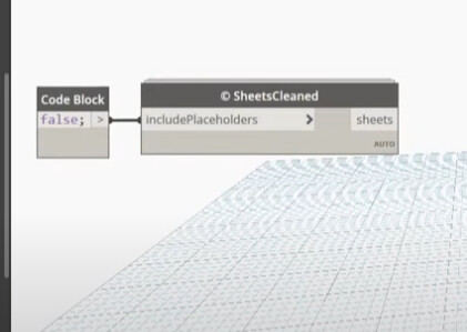

@GavinCrump I found this youtube video of yours but cant find the node attached to it.
It is now called Collect.Sheets
You can find it under Revit > Collect. I decided to put all the collector based nodes together as they used to be all over the place. Generally all nodes are named with their second group level first for ease of navigating the package.
