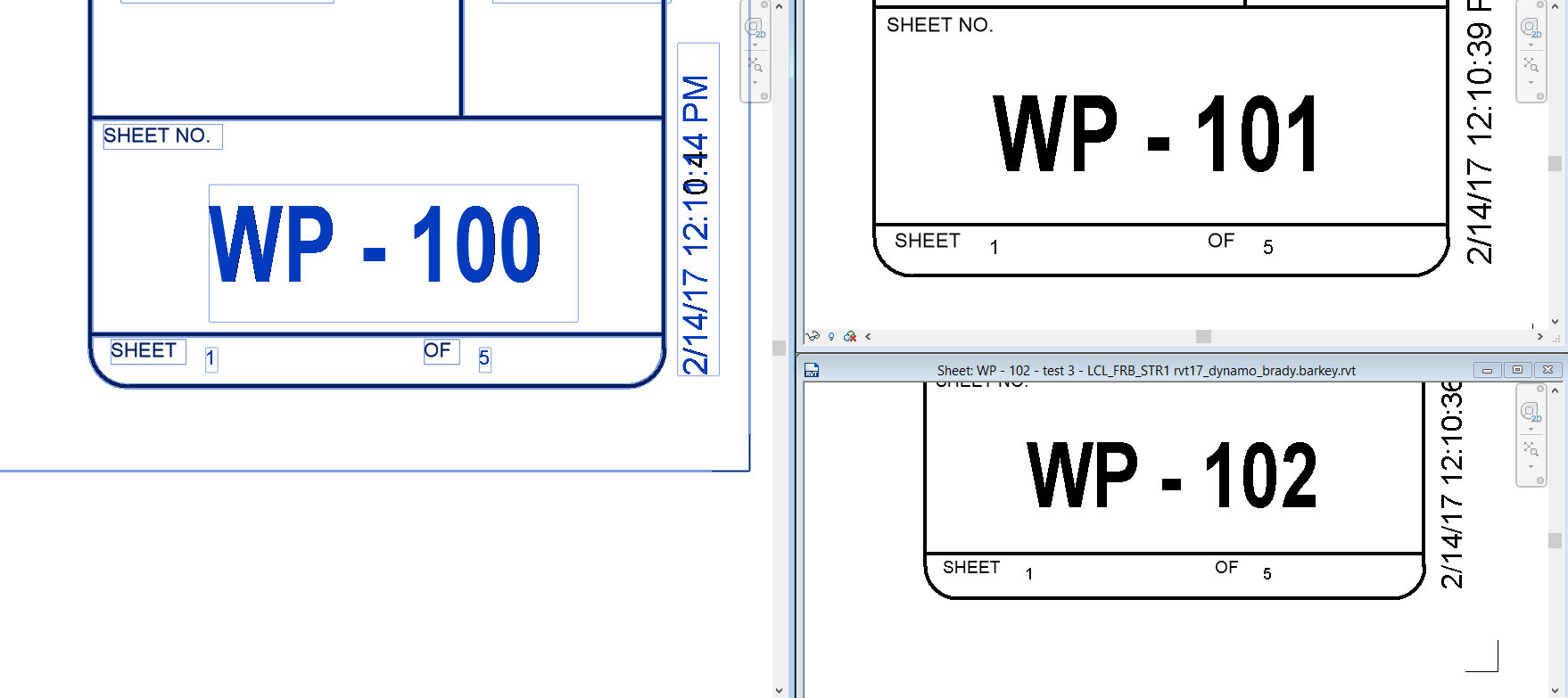

Sorry if this is a simple solution (I’m just not seeing it!)…
I have (almost) created a script that filters through my sheets and (wants) to fill in the ubiquitous “sheet x of x” labels on my titileblock.
I can filter the sheets, count them and even get the latter part (“of x”) of the label filled in, but I can’t get the first part of the label to fill in on the sheets…
Can someone help me see why I’m falling down? I think I’m not seeing how lists are applied to a particular node(?) or I’m not using the right node?..
