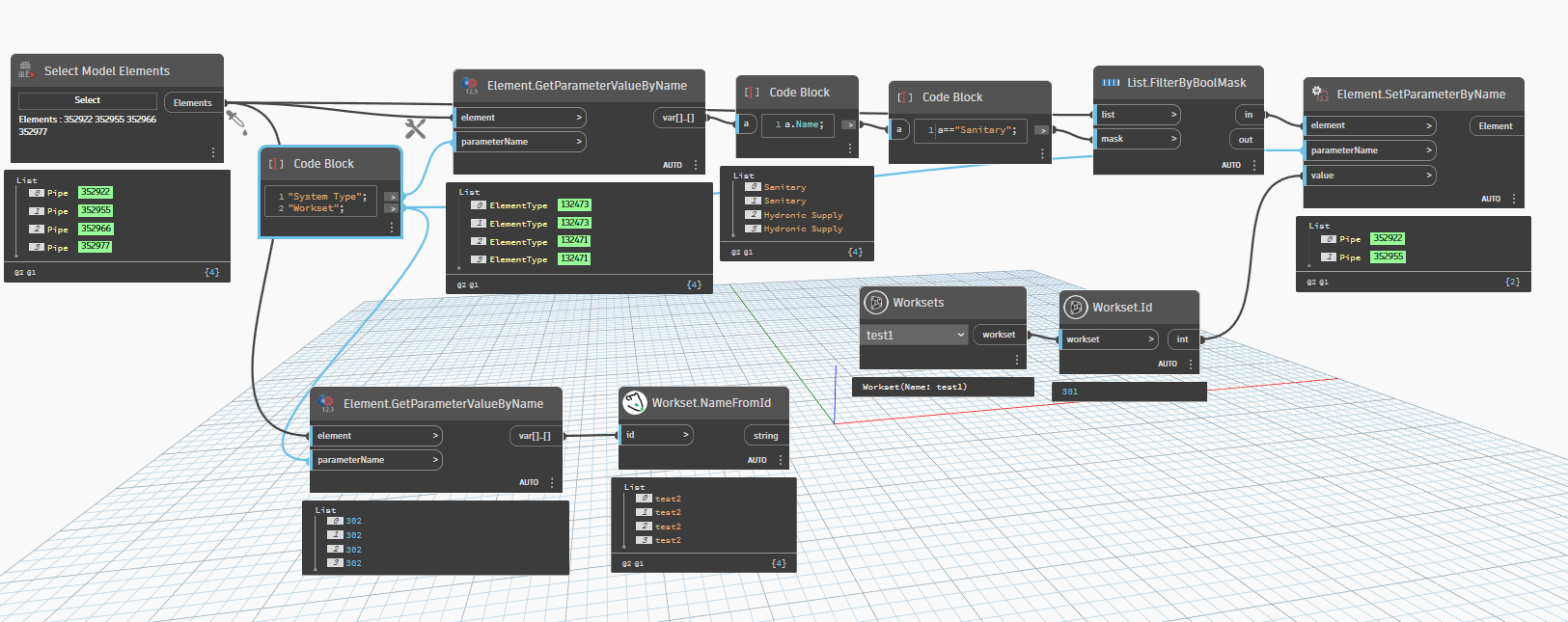

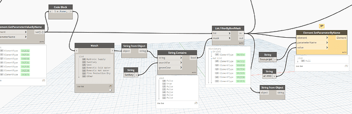

hello,
i doing a script in dynamo to set the workset by the system type in pipes but i have a problem (see pic and script) if someone can helpme will be
great
Hello @raphael.abouasaliMXM and welcome to the forum :wink: something here maybe, keep in mind workset is controlled by id
