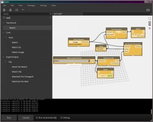

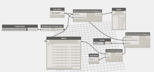

is there a way of way of setting the top level of a colom to a set level?

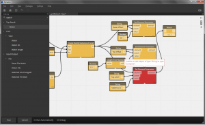

I have tried to work with set element parameter by i get an error that i try to set a cointainer value not a string… And is doesn’t seem to be an option to make a container…
In the latest version of DSDynamo, you don’t need the “Elements to IDs” node any longer. It pulls the ID of an instance automatically when an ID input is required.
