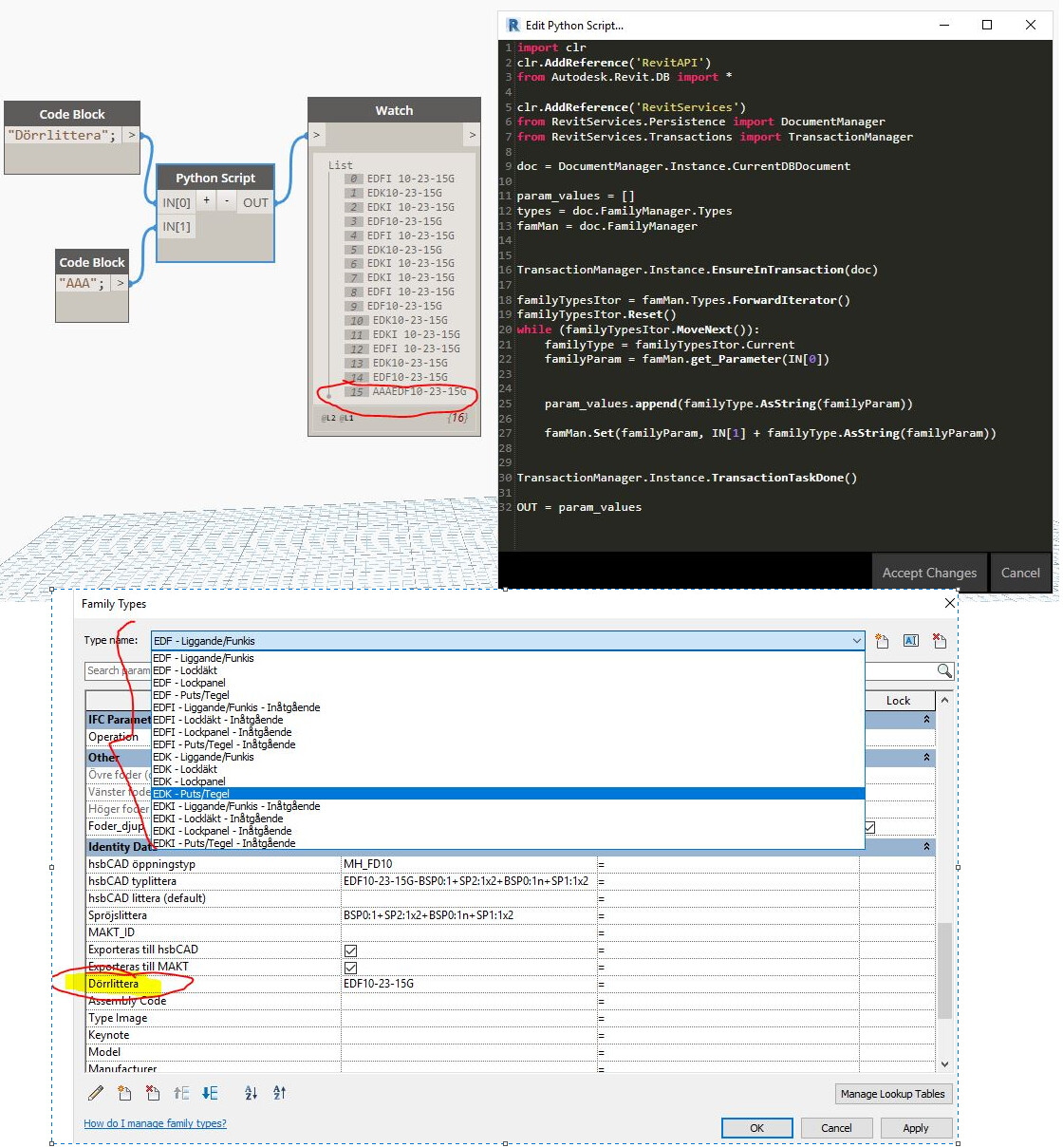

I want to edit the parameter called “Dörrlittera” in the family editor. Just to get it to work i am trying to append the parameter with the string “AAA”.
If i understand this correctly there is 16 types of the parameter called “Dörrlittera”. As can be seen in the image.
I want to iterate through them and edit with Set().
But i can only change one of the types for some reason…
What am i doing wrong? The code seems to be working fine, except the “Set()” function.

hi @staffan.gustafssonTY
add this line:
famMan.CurrentType = familyType
before this line:
famMan.Set(familyParam, IN[1] + familyType.AsString(familyParam))

-biboy
Hi blsalvio
Its working perfectly. You made my day :slight_smile:
I can finally continue, thank you.
