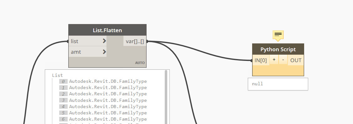

Hi all,
I try to set some parameter values in a FamilyType.
In my first script I was able to add the parameters to my familydoc.
What I want is to get those parameters and set them in the FamilyTypes, but I wonder it this even possible?
clr.AddReference('RevitAPI')
import RevitServices
#Start Transaction
#TransactionManager.Instance.EnsureInTransaction(doc)
#Eind Transactie
#TransactionManager.Instance.TransactionTaskDone()
familytype = IN[0]
param = []
for f in familytype:
	para = f.FamilyManager.Parameters
OUT = "Succeed"
File “”, line 19, in
AttributeError: ‘FamilyType’ object has no attribute ‘FamilyManager’

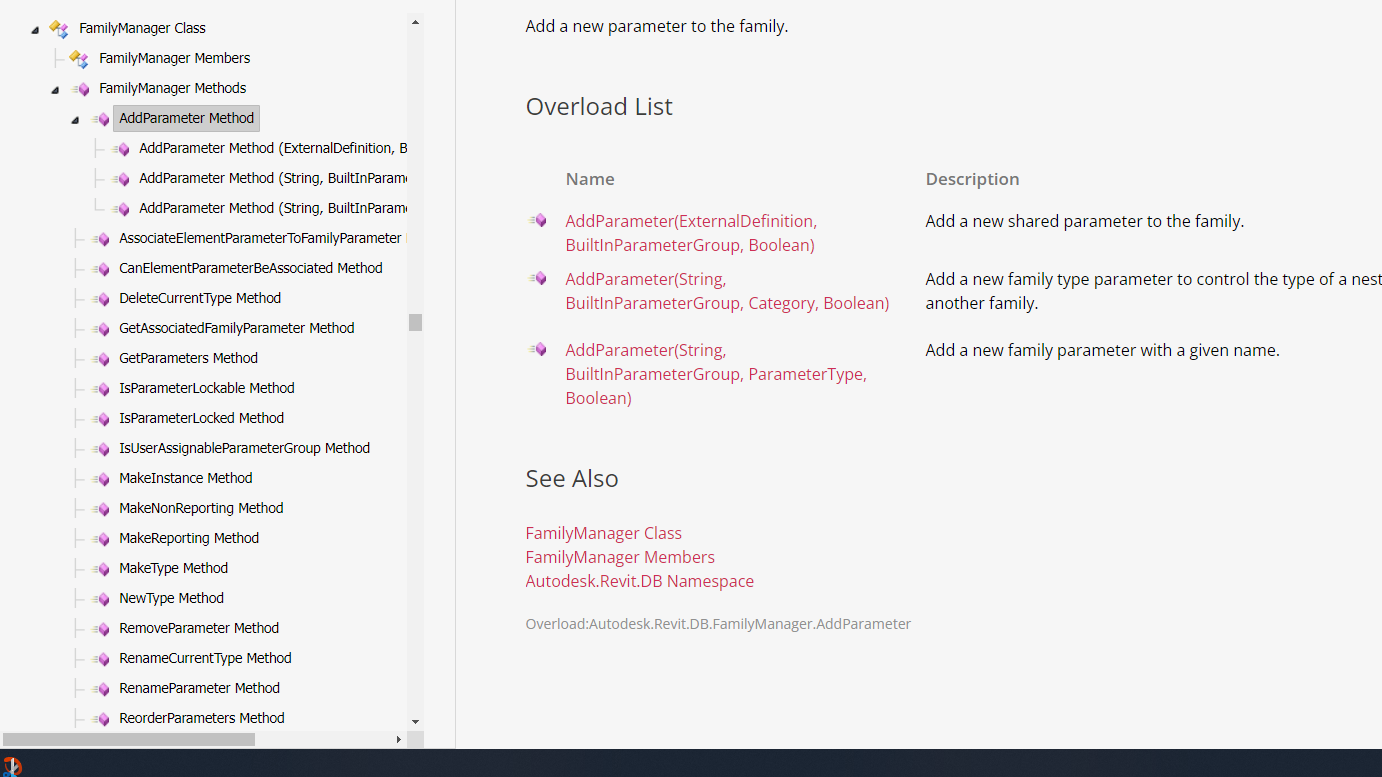

Firstly, In order to use the FamilyManager class you must querying a family document.
The API docs description of what the FamilyManager class is:
“The family manager object to manage the family types and parameters in family document”.
Secondly, all family types within a family document have access to the same parameters. Therefore the .parameters property will return all of the parameters in a family document. Within which, each family type can have different values against the same parameter. Rather than tying to get the individual parameters from each family type as you are.

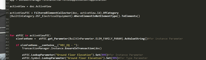

In python if you have a familyinstance, you just need to add .Symbol.LookupParameter(paramname) or if BIP .Symbol.get_Parameter(bipname)

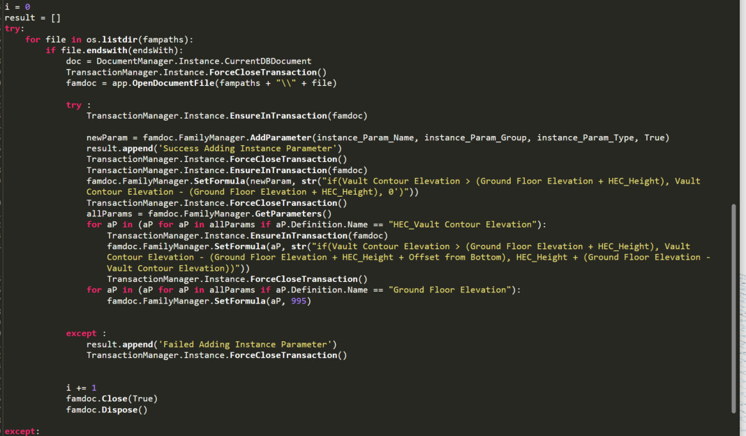

if working inside the family, then majority of your methods sit within the FamilyManager class. you cannot specifically add a parameter only to a single type within a family, the parameter is introduced to all types within the same family, but you can add the parameter and define if it is an instance parameter, it defaults to type i believe, and can add formulas accordingly. This is a script I use to mass edit families in a file location as an example of some of those actions:
