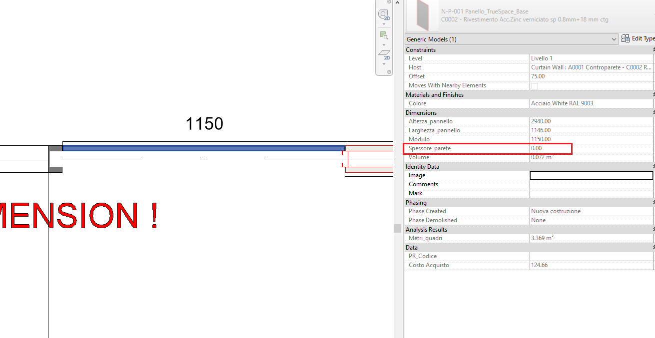

This is how I watch when I select nested family. I want to set the parameter I highlighted in red. It isn’t linking with family parameter. In dynamo I can’t set this parameter.
I’m searching a solution without python. I have found a solution that is a compromise: create a new project parameter and assign it at generic model. This isn’t the best solution I know, but this is the fastest. What do you think about?
Hi! Im facing now the same “problem” but it’s the way Revit works. You can modify shared parameters of nested families only if you are inside the host family and then you reload it inside the project. You can bypass this process linking the nested family parameters to the ones in the host family. But I havent found any workround unless i run the script inside the host family.
