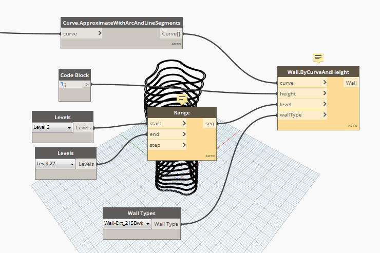

can u please advice if there is a way to sequence revit levels.
the curve input is 20 no:s curves, and the wall should be placed at all levels from 2 to 22 according to the curve.
This script will get you all the levels of your document (unfortunately, I did not remember from where I got it in the first place). Try running it in a Python node, and then just query the corresponding levels (based on their indices)

OUT = FilteredElementCollector(doc).OfCategory(BuiltInCategory.OST_Levels).WhereElementIsNotElementType().ToElements()
Something like this? The second part of the graph is to sort them by elevation, don’t know if you need it
