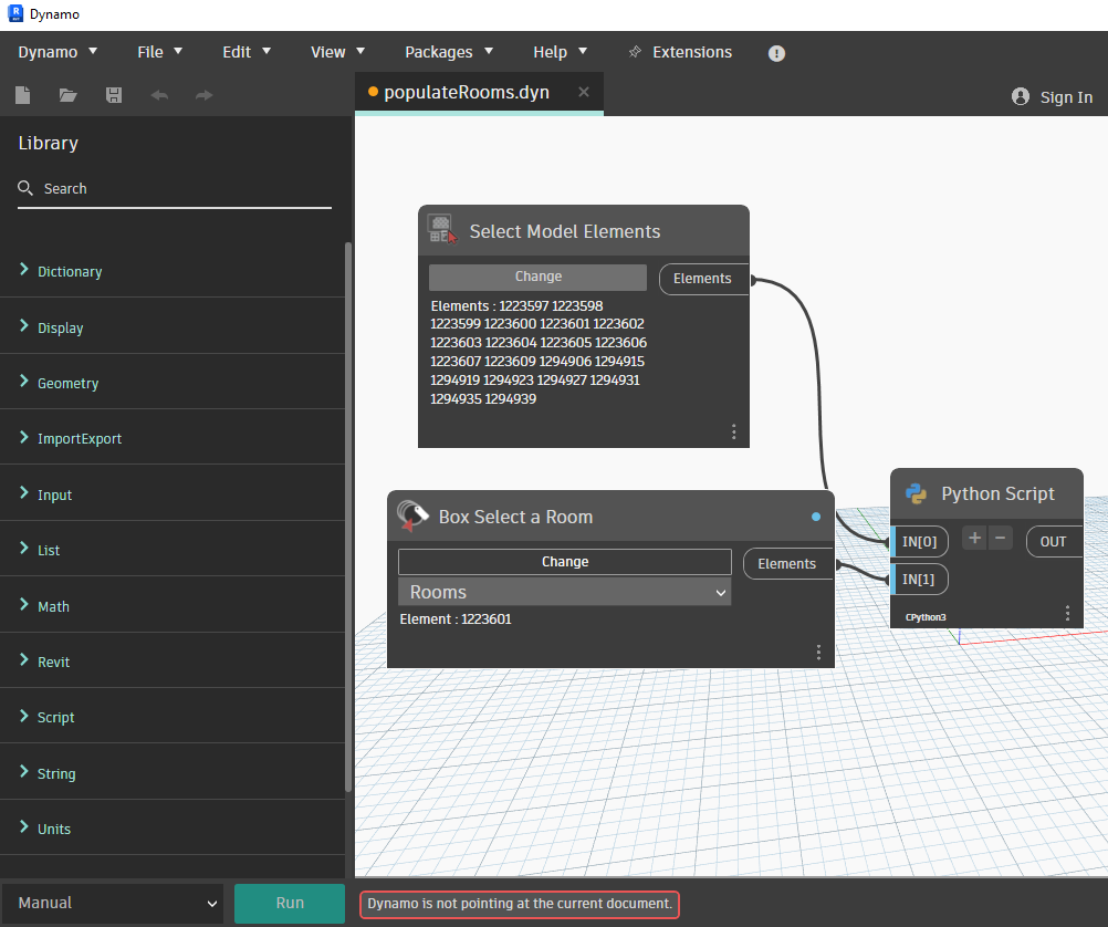

I’m writing a Revit Dynamo Python script that needs elements from two documents (I want to copy some stuff between the documents).
I have two selection nodes, and everything works as long as I select in the same document.
However, when I switch to another document to do selection, Dynamo won’t let me and shows “Dynamo is not pointing at the current document” error at the bottom (see the image).
Could you please help?
That’s going to be more complex if you are going from A → B and B → A at the same time.
It will be a lot simpler if you first do A → B as one script/step. And the B → A as a second script/step. Most likely the same script(?)
To do it all at once, you’ll need to first get both documents. Then get the elements from each of the documents. This can be more difficult as the Select Model Elements is limited to one document.
You could highlight the elements in Doc A and then in Doc B. And then you would have to use dynamo or python to get the selection from each of the documents. And of course, you’ll need to keep the elements and documents straight as you move them about.
From the little we can see, I’m guessing you are taking elements from one document and then moving or copying them to a second document’s room(?) If that is the case, the best approach would be to just select the room not with the UI, but by number/name.
We need more information. What exactly are you trying to do? There are plenty of ways to interact with multiple documents but it all depends on what you need and what you want to modify.

You’re bumping into the limits of the Dynamo UI.
You probably need to use a temp file or some intermediate storage method to do what you want.
  • Select Objects to be copied.
  • Start script.
  • Copy the info of the elements to a non-modal dialog.
  • Move to second document.
  • Select room.
  • Hit Ok on the non-modal dialog to run the second part of the script.
Not the simplest thing to do - but it can be done. I wouldn’t use dynamo for this application.

A second dyn would certainly do the trick. Selecting across documents via the UI is not easily doable, and in some cases not doable at all.
What sort of content are you trying to gather? It might be easier to grab things programmatically, or as others have suggested, use a ‘pre-run’ graph in the source file which extracts the data into either a Remember node or an external file such as a json.
