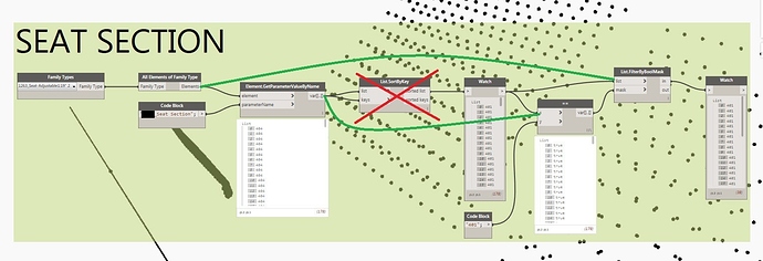

Hi all - I am new to Dynamo, so apologies for a seemingly simple question. I have a family that arrays a seat family in a stadium. The parent family (a row of seats) has a parameter that defines the seating section value (the 401 in the screenshot below). I can pull a list of the parent family instances based on the seat section parameter, but am lost as how to instead select the individual nested seats with the parent family. Any help is greatly appreciated!
FYI - the seat family is set to be “shared” - you can see the points in the background, so this doesn’t appear to be the problem…
