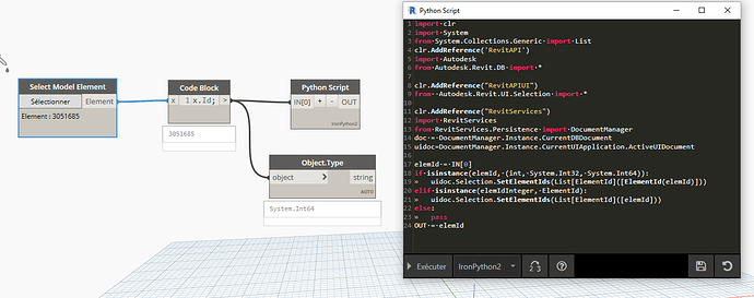

Hi there c.poupin
I was reading this post and noted this solves a problem similar to mine.
I’m not an advanced python user, so this script is a bit complicated for me.
I have a similar problem, only I need to highlight just one element whose “Id” I already know.
Could you help me: Which part of this python script can I take in order to solve this?
here an example
import System
clr.AddReference('RevitAPI')
import Autodesk
clr.AddReference("RevitAPIUI")
from  Autodesk.Revit.UI.Selection import *
import RevitServices
uidoc=DocumentManager.Instance.CurrentUIApplication.ActiveUIDocument
elemId = IN[0]
if isinstance(elemId, (int, System.Int32, System.Int64)):
	uidoc.Selection.SetElementIds(List[ElementId]([ElementId(elemId)]))
elif isinstance(elemIdInteger, ElementId):
	uidoc.Selection.SetElementIds(List[ElementId]([elemId]))
else:
	pass
OUT = elemId
