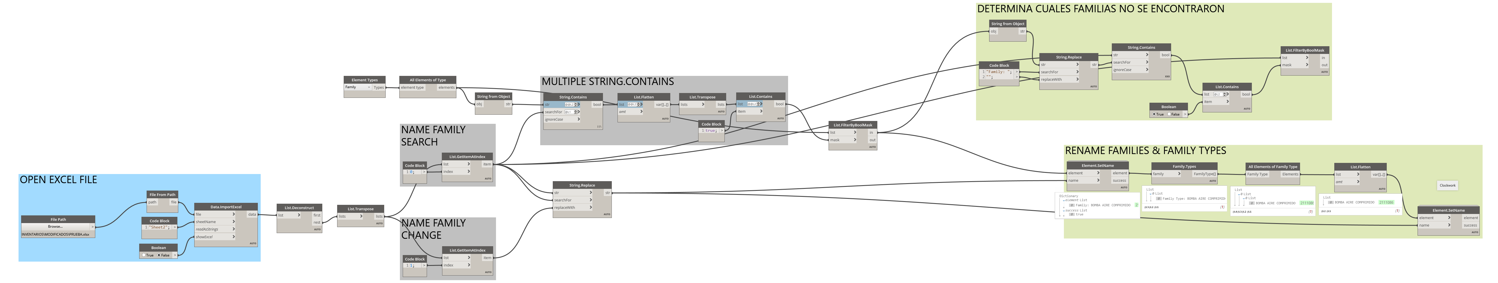

I have been select all families in the project and I applied a filter to obtain only the families listed in a Excel file.
These new list of families I should rename them with new names in the same Excel file.
I have a dynamo script for to do this actions, but additionally I need select all family types for each ones families selected previously.
I select the family type of family but I can’t rename them
I used “Element.SetNane” of Clockwork and works fine whit families but doesn’t work with family types.

The node has no way to know that you’re trying to change the type name. In both spots you use the node 'Element.SetName` your input is an Element object. Taking a look at the code itself, when it encounters an Element object, it just updates the Name attribute.
If you want the node to update a different parameter, you need to give it that parameter instead of the element itself. I’m not sure if this will work, since the script is looking for a FamilyParameter specifically, but try putting this after your Flatten node, and before your Element.SetName node.
