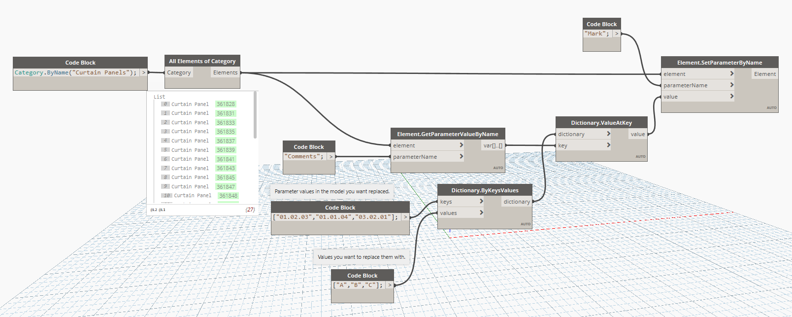

Your solutions have been illuminating for me, maybe I did’t explain well the point, i would select elements with specified values in a parameter and then change another value parameter of them, so it’s not only 2 value. I tried this solution following your advice, maybe I got the point, what do you think? my script will explain better than me :smiley:
You notice that you’r only changing 4 elements out of 500?
Change the wiring here:
You really should tell people what your goal is with a piece of script this kind of replacement can be handled with a dictionary really well:
(Or assuming from your example, you can also just read the value, strip all the characters except the last one and push that back)
