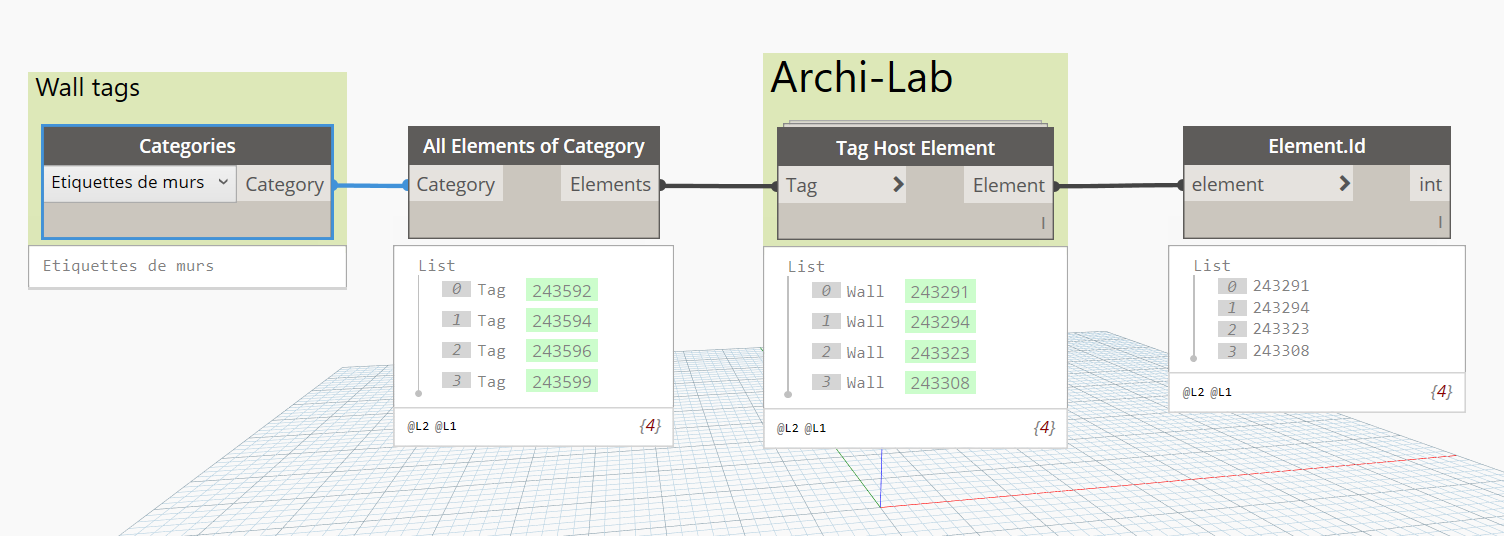

Hi @jup ,
for tags there’s a node in the archi-lab package :
for dimensions, I don’t know of any existing node that retrieves the reference elementd. So here’s some code :
