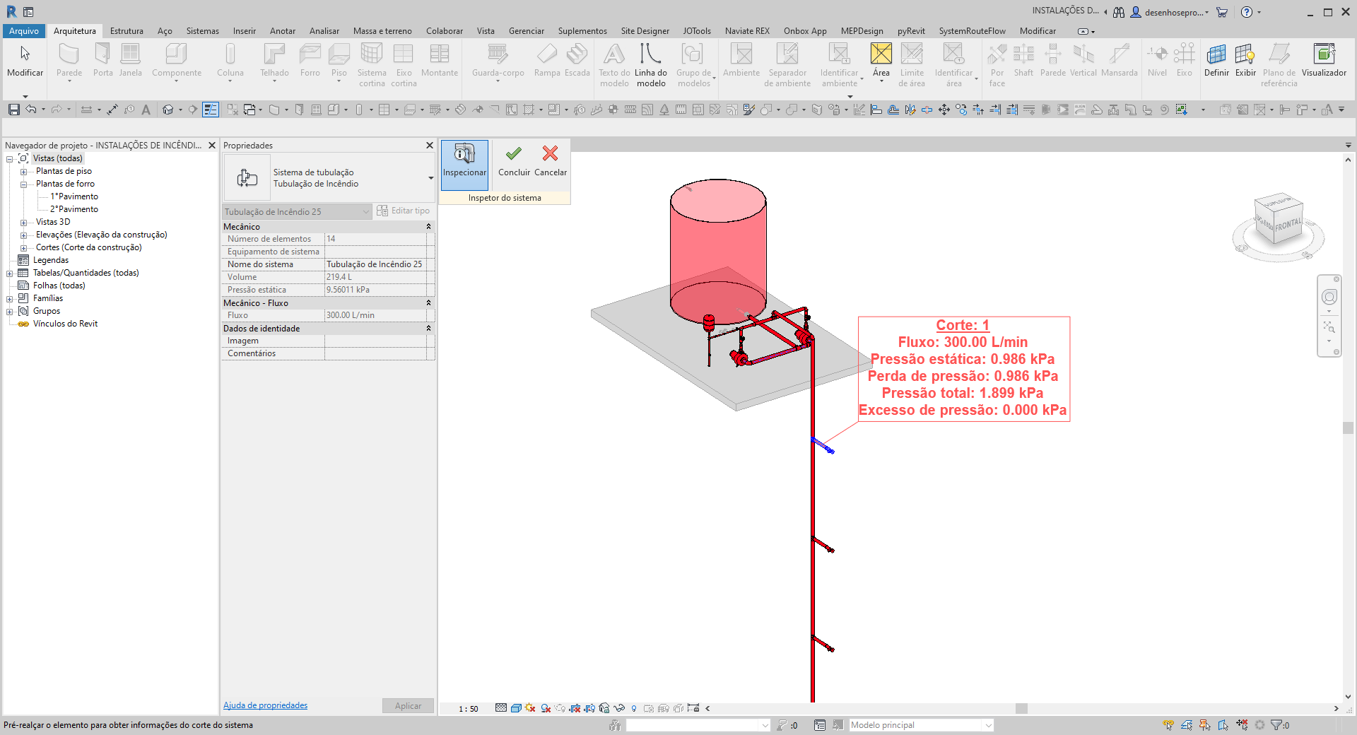

Good afternoon
I need help with filters

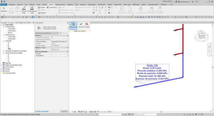

I want to filter the tubes on the red arrow section 1 but dynamo filters the section 148 on the blue arrow

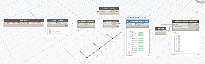

PROJECT
Everything is going very well but I need to increase the level I would like the same procedure to be done automatically for example
the values in “1”
Section 148
Section 141
Section 60
Section n …
be filled in 2?
