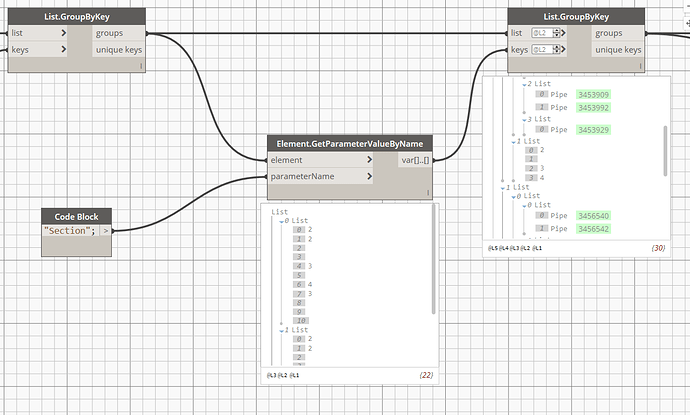

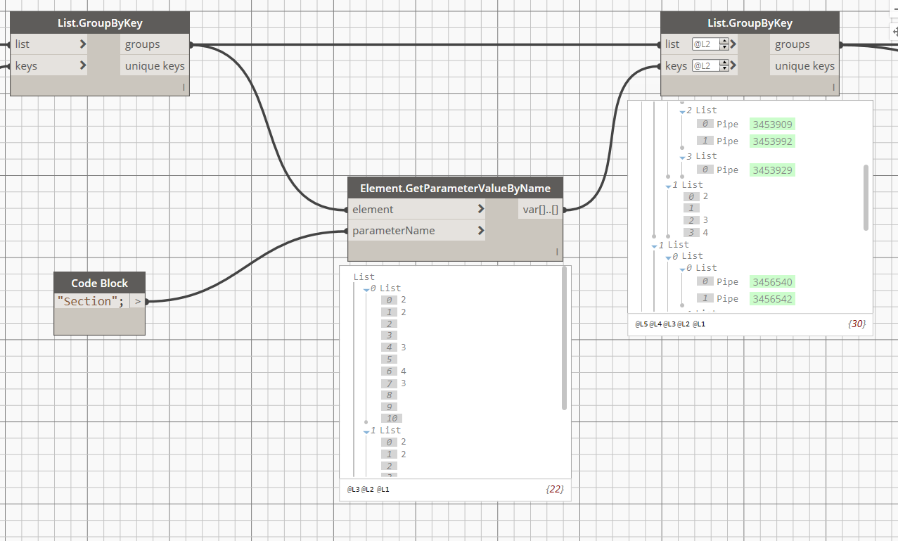

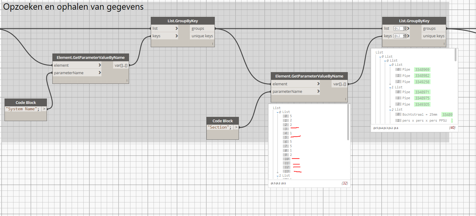

Can I replace the empty value with the connected value?
In my script am I looking for the revit parameter Section.
This parameter is only visible by my pipes and not by my pipe fittings.
But when a take a Pipe Pressure Loss Report I see the sections.
As you can see find dynamo not all of them.
Is there a way to search for hidden revit parameters?

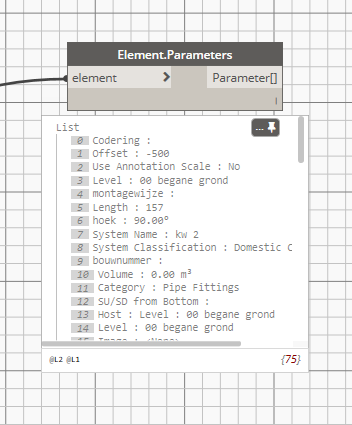

You can look at the parameter of a element with the node Element.parameters.
Thank you,
When I select the Pipes I see the parameter:
section%20true
And when I select the Pipe Fittings (bend) I don’t see it:
section%20false
I think that is the reason you get blank results because the element doesn’t have the parameter you want get a value from.

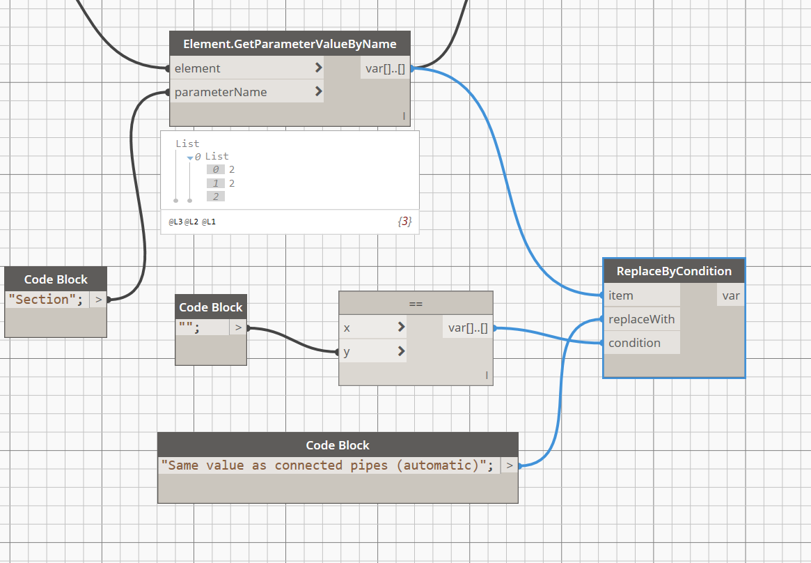

I am missing value in my Section (see below)
Can I replace the empty value with a new value?
I want that the value is the same as the connected pipes. Is this possible?

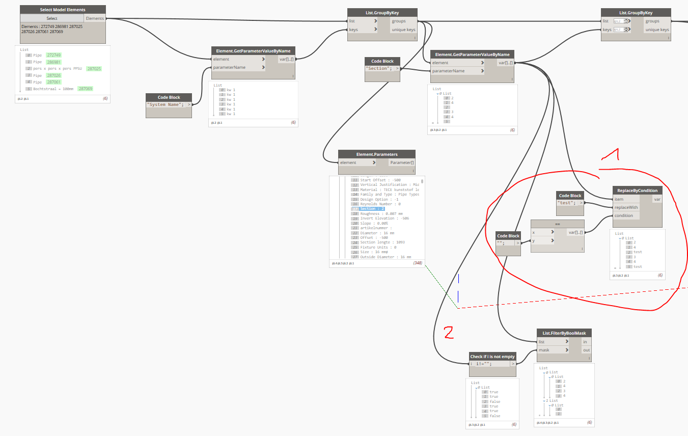

maybe like that:
Thank you, but that’s not the solution yet. As you can see at my script am i filtering by system name and after that by Section, so my pipes do have a Section but my fitting don’t thats the reason that the value is empty.
I need the code of this:

You can replace an empty value with your section.
But i don’t know how your fittings and pipes are connected. So i can’t place the right value in it.
For my example i placed “test” into the empty slots.
When you have a list with boolean values you can use the BoolMask node to filter a list by your boolean values.
Maybe this helps…
There are ways to check which fitting is connected to a pipe:
Thank you again, almost, the test needs to be the connected value and i want it automatic.
