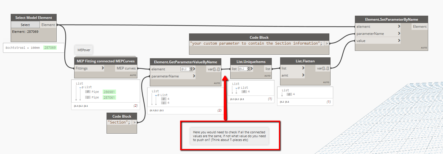

How can I get the section from a pipe fitting? I can only get from the pipe segment.
The pipe section from Fittings is only shown on the “pipe pressure loss report”
Thank you very much!
