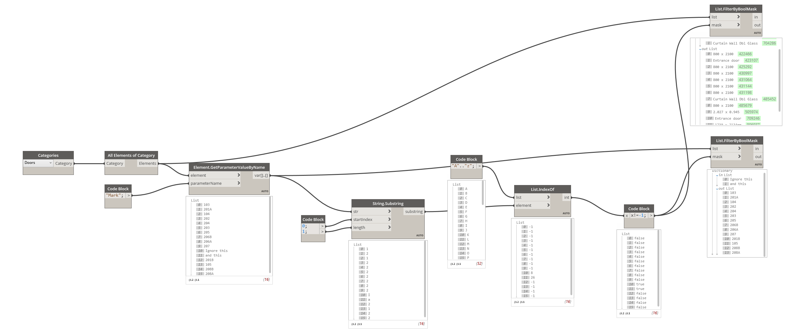

Hey guys, I’m looking to be able to filter (like true or false) a list if it has a letter in it.
What I’m trying to achieve:
I am going to replace all the Mark Values with Element ID. I got that script to work no problem.
Issue is, before i can apply this script i have to search the Mark Values and make sure no one has put a “comment” in it. Typically it is something like “Panel xyz needs to be connected to wrx”. In any case, it could be a mix of letters and numbers. Since the Mark Value should ONLY contain numbers, i want to be able to filter all my marks by separating the ones that have this potential comment in there.
I tried different methods. I just do not think i have my head around a way to filter by letters. Here is what i have done (I’ve tried different approaches but don’t have it on this clip)
Let me know if there is a node, method or even a thread i can look in.
I highly appreciate your time and help and am learning every time i come here. Thank you for your time.

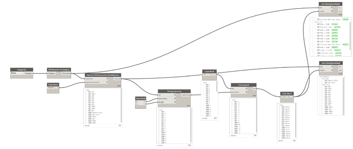

Use cross product instead of @L1 for the String.Contains node. This will give you sublists of n string checks based on your n-sized alphabet.
You can count the number of ‘true’ hits in the sublists at this point to determine how many letters exist.

@DaftPooch Try this:
I’ve removed your dependency on packages and also made sure that capital start letters are also covered in the check.
Also, you don’t need to type in a through z in the code block you can simply use
“A”…“Z” or “a”…“z” or “A”…“z”
Just use the same boolean mask to filter the elements as well.
