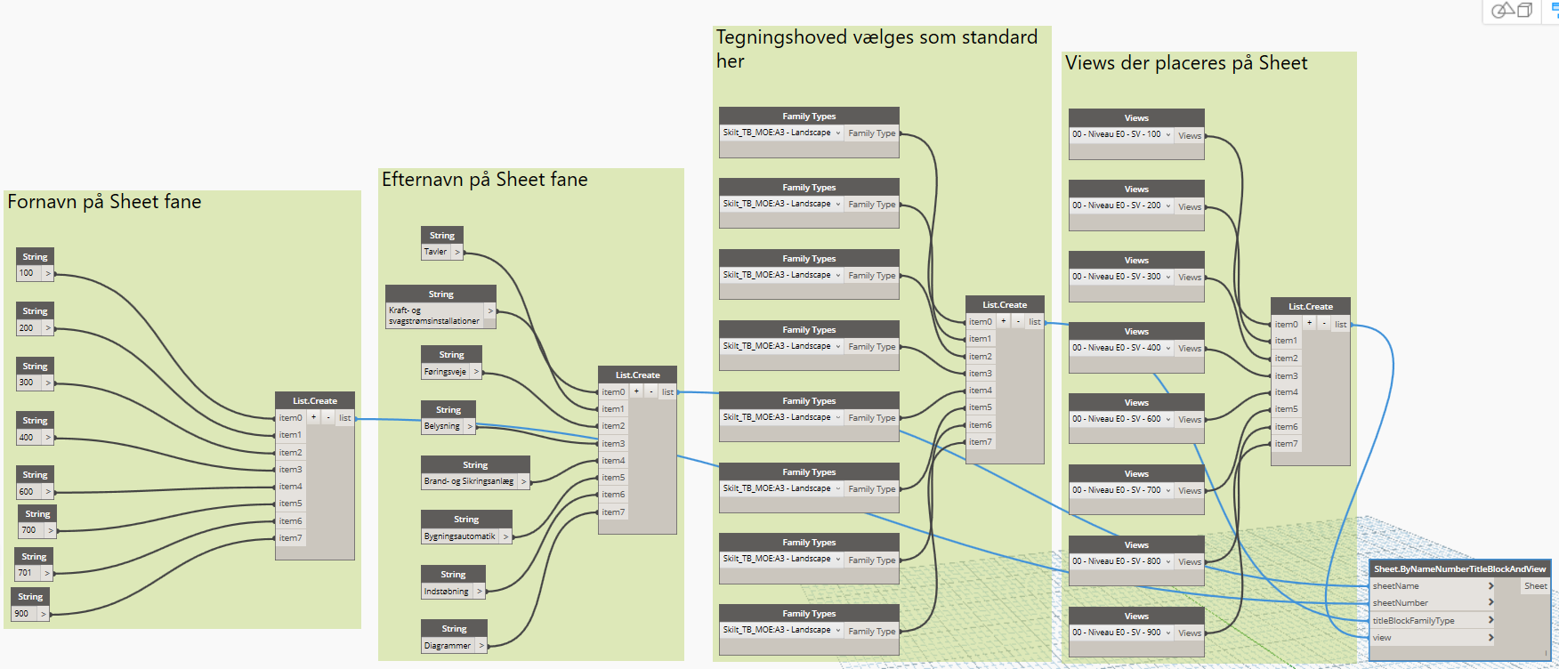

I am trying to create a script that places Views (based on Floor Plans) on Sheets. It still needs some adjustments I know, but I can not figure out why the script put the sheets in a subsub-section in Revit…?
I have found suggestions here in the forums but there is something I am missing…
Any thoughts would be nice

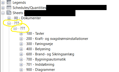

This has to do with the way you have set up your browser organisation. You most likely are sorting them based on a parameter. All you need to do is give that parameter the value that it needs. Triple question mark (???) is for when those parameters don’t have any value.
Hope it helps.
Thank you for your answer! I am not quite sure I understand what “browser organisation” means…?
I have tried to use sort nodes (Accending) with list as input and var[] as output. But that did not help.
The browser is setup standard accordingly to our firm and exact like in your video post.
