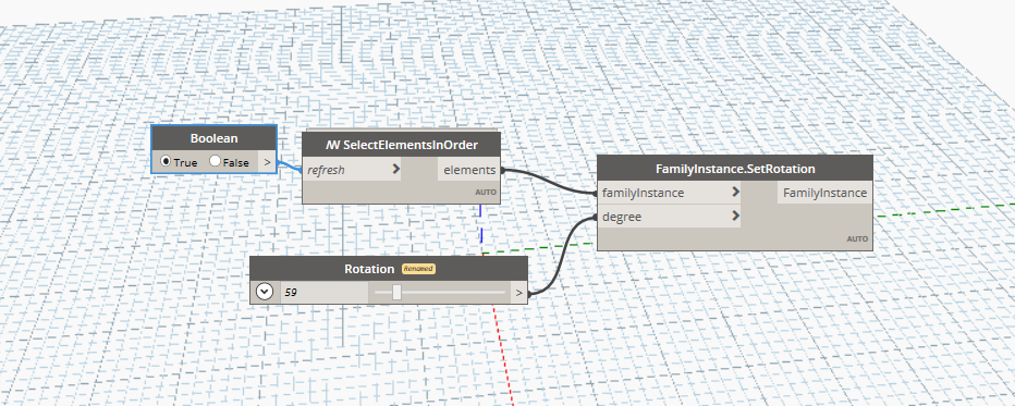

I wanted to rotate multiple Voids. (pic 1)
The problem is that the Family is horisontal.
So when i use the “Family.instancesetrotation” node, it rotates on the wrong plane.
Here is the script:
how can i solve this?

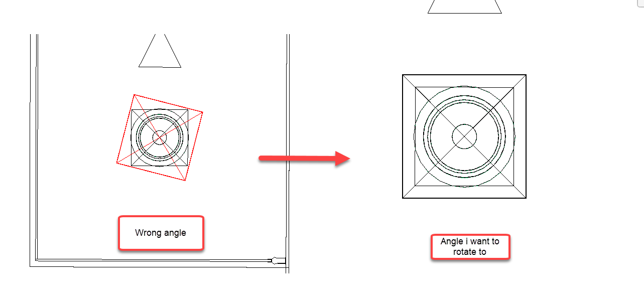

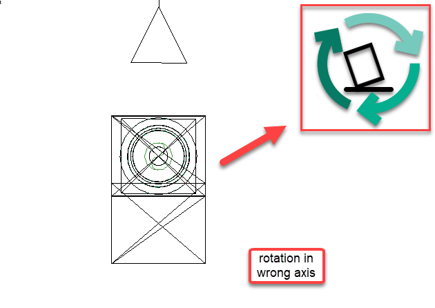

Hi.
the direction is not the problem.
its the way it rotates.
please that a look at the photo below.
I want the object to rotate in the blue axis.
its currently rotating at the red/green axis
