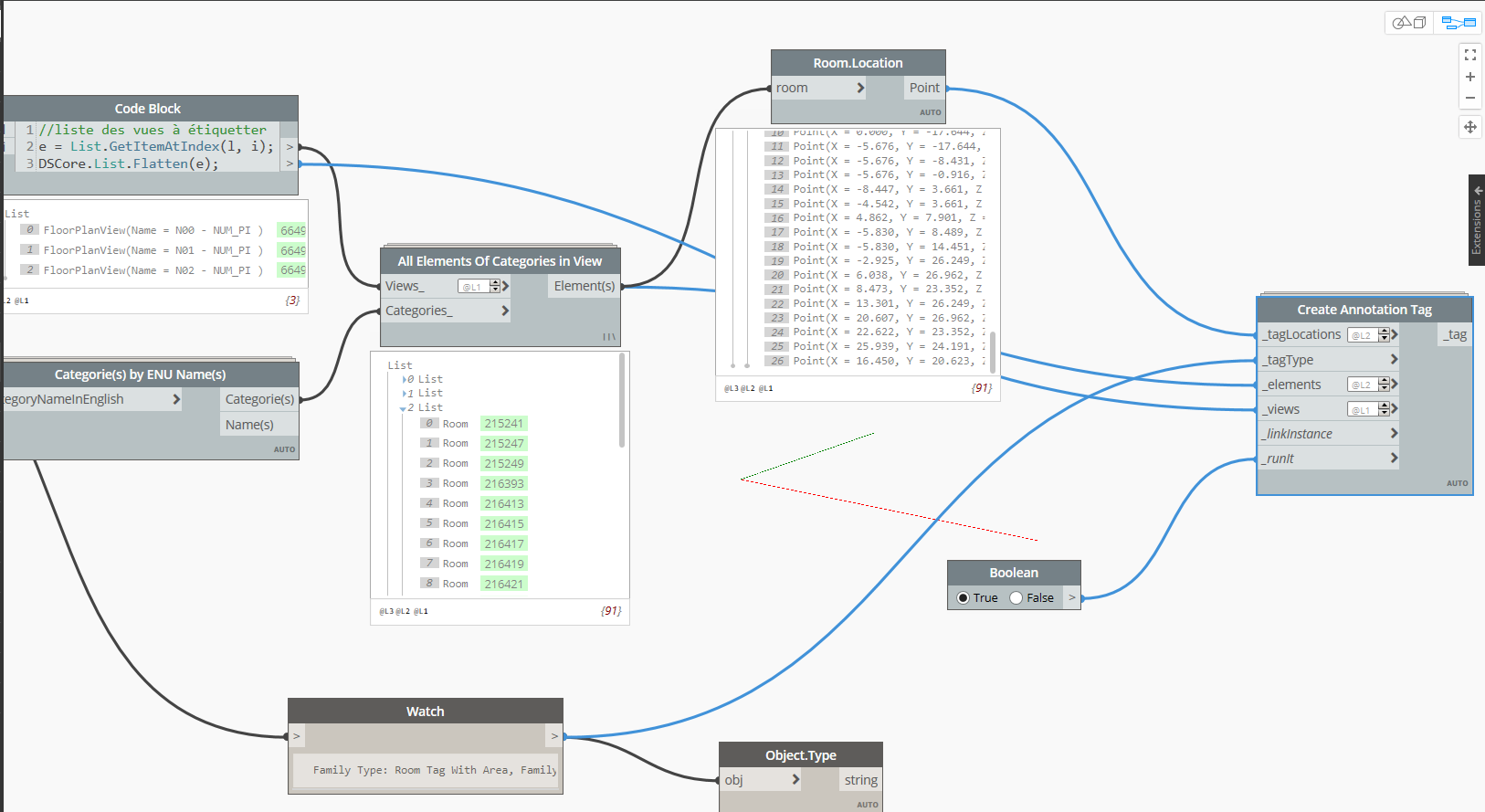

not sure what’s wrong but i get this funny error message and no tags are created

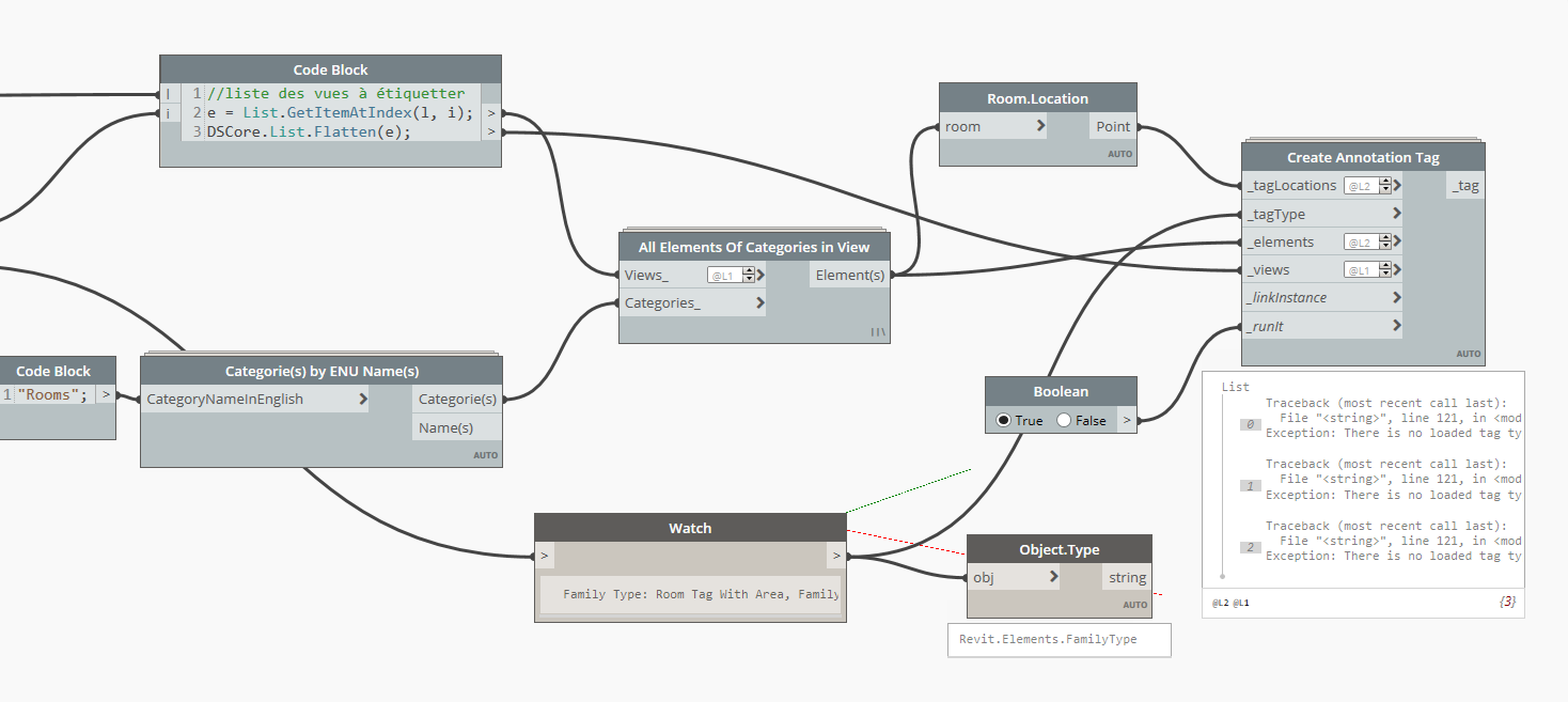

The error seems to state that there’s no loaded tag type with that name (at least for the category of elements you’re tagging).
That part i got
but i’m definitely feeding a room tag (you can see it in the watch node) hence the reason i’m confused.
Can you show the node previews of everything? It could also be that your list levels are off and python is treating a list as an element and “not finding an appropriate tag for that category”.
Can you try running it on just one list/view and see what happens?
Hi could it be an unit issue…
Turns out it was a language issue in the node, now fixed by @Konrad_K_Sobon
