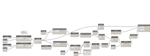

I created, re-created a definition based on Konrad Sobon’s occupancy post. My Area is not updating when I change room sizes in the revit model. I have to disconnect a node, run, reconnect and run for it to update. Is there a way to get it to update automatically. See image of definition and video re question: http://youtu.be/lgmzXHbGfAk
Thanks in advance for any help,
Marla
Marla,
I am glad that you found my video helpful.
The answer to your question is no. Dynamo at the moment doesn’t monitor changes that might have occurred in Revit DB during its execution. The method that you mention is the only reliable way that unfortunately I have came to relay on as well.
