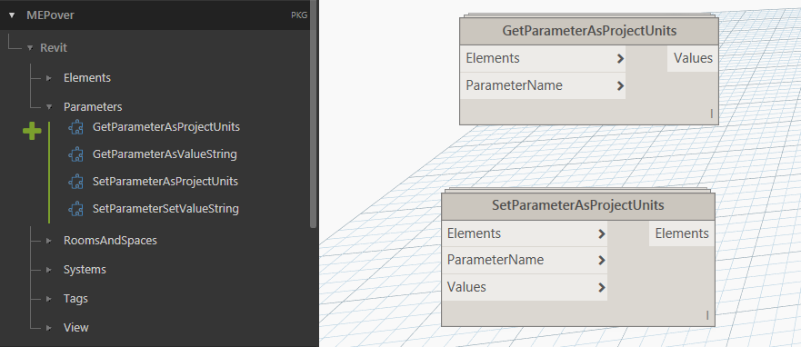

Or you could use one of the nodes in the MEPover package to get and set the values as you see them in the Revit UI:
