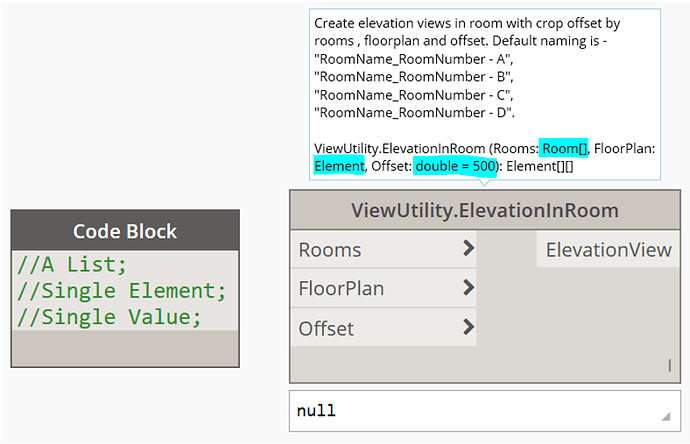

hi @vanman, node’s input values for your info,
(Please update the latest version of Quasar Package) :grinning:
for more info & usage : https://twentytwo.space/quasar-package-guide/
