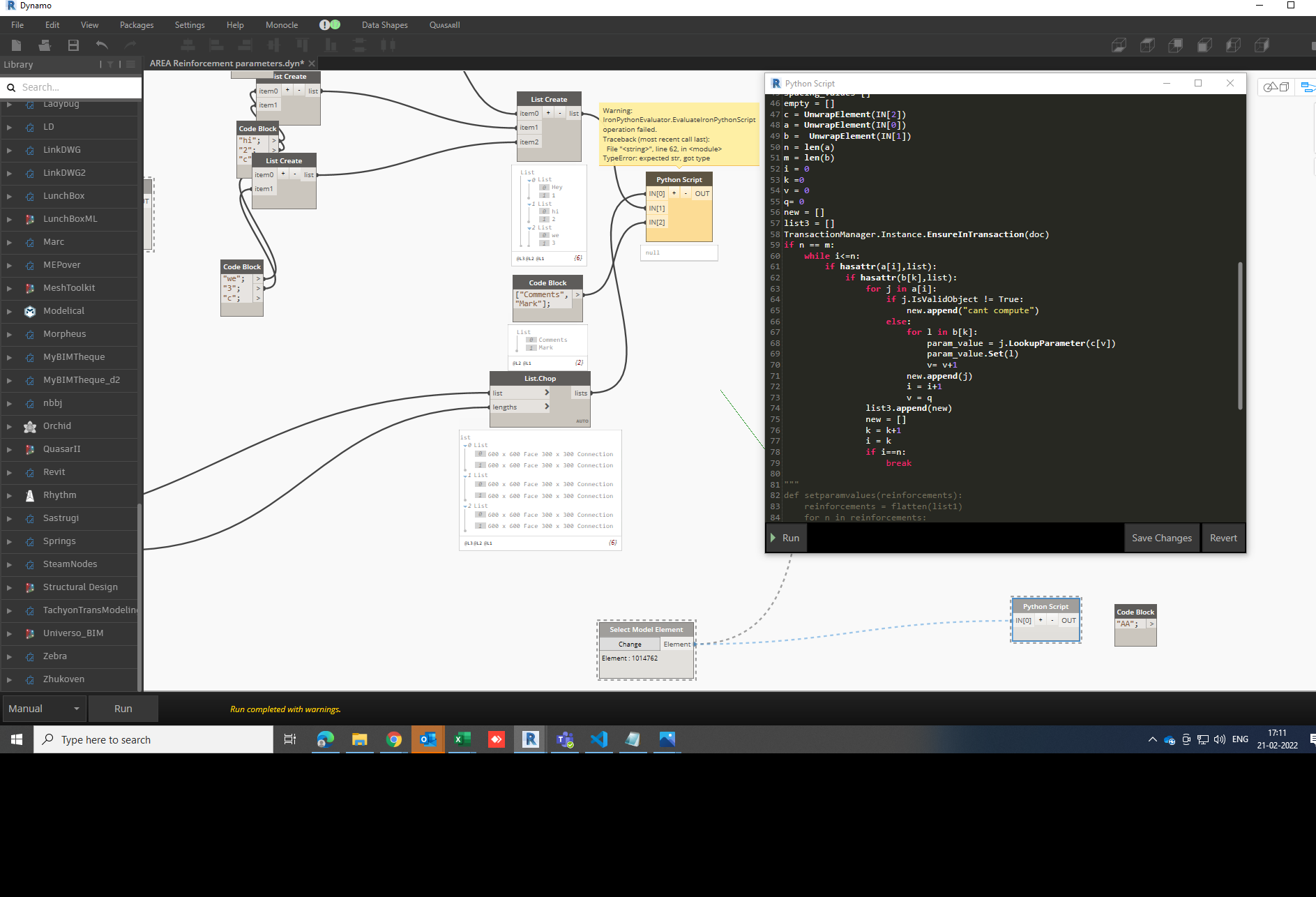

Hi Everyone,
I am trying to update the values for Air terminals. I am getting an error at line 68, expected string but got a type. I am trying to resolve this and Meanwhile any help from anyone would be highly appreciated.
