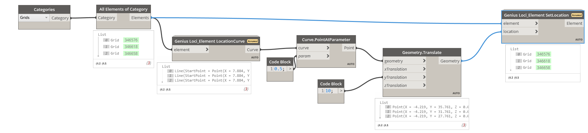

I’ve found loads of topics about changing grid extents or creating grids in Revit.
But I can’t find out how to move existing Revit grids using Dynamo.
Is this possible? Can anyone point me in the right direction please?

Hi @Alien,
This is indeed possible to move grids.
I’ve added this functionnality in the latest release (v 2021.6.16) of the Genius Loci package.
Move grids.dyn (13.5 KB)

Hi Alban,
Unfortunately this script is not working for me. The grids are not moving, I am just seeing middle points of the grids showing on Revit.
You have to use the latest release (v.2021.6.16) of the Genius Loci package.
