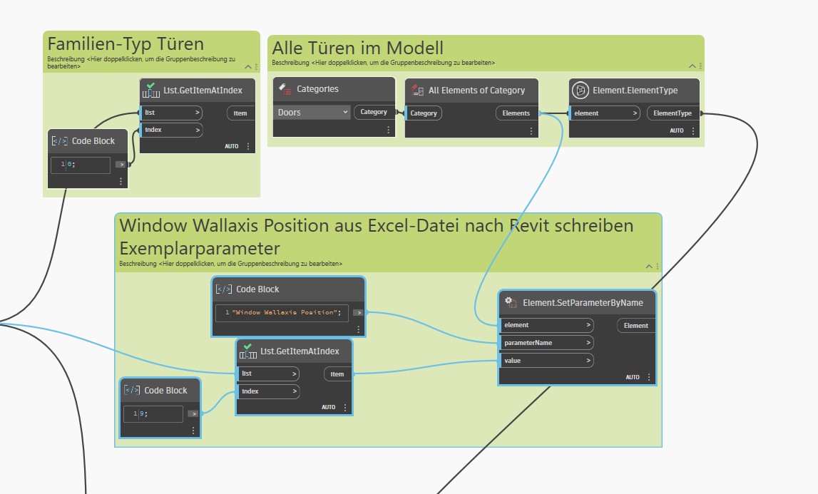

use Element.Set.ParameterByName for “Window Wallaxis Position” with new value 60. No error message after exe, but the value is not changed? please see attached file Screenshot 2025-07-28 113423|690x398
when I run Data.ExpoortToExcel again the values in Excel are changed!! but not in Revit visible??? Family only shows 50 for “Window Wallaxis Position” ???

If youre not doing get and set values to/from excel id suggest doing that. You might be writing back to your excel before reading it if doing it in one script, which would explain the behavior your describing.

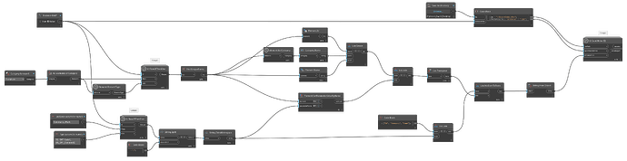

It looks like you’re relying on some fairly manual data isolation strategies there, so I’ve built an example of how you can more scaleably manage this (just with text parameters in this example). From what I can tell you’re mixing/matching instance and type values which has the tendency to get confusing as well.
See below example of how I’d go about a toolkit like this. It’s intended to be ran via Dynamo player (doesn’t suit multiple runs in dynamo itself). Uses Crumple package.
Export Revit data_R23.dyn (48.8 KB)
