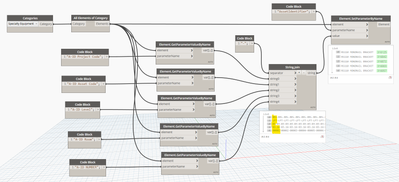

I’m trying to generate our AssetIdentifier parameter from several other parameters.
I’m new to Revit and Dynamo, but have used Maya in the past, so my old dependency graph knowledge has helped a bit.
Can anyone de-bug the attached and let me know where we are going wrong?
The output should be BEL-LFT-03-03.16-00001 etc… but it’s listing them vertically (as highlighted), instead of for horizontally in the String.Join preview.
The previews in all the Element.GetParameterValueByName are correct, so I’m not sure why it’s not stringing correctly.
Any help would be appreciated.

It’s hard to see the content of image.
But if you want to combine multiple values to one, use the code block with something like
[a+“-”+b+“-”+…+n]
where n - the last input

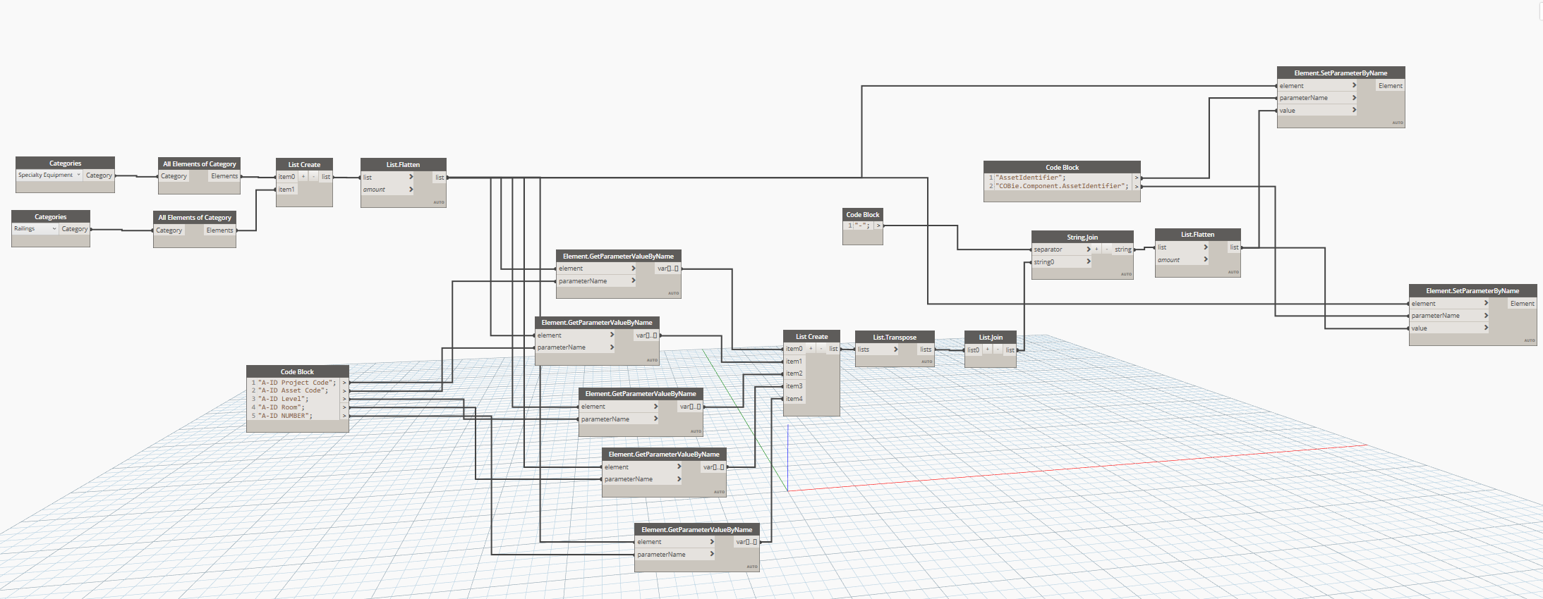

I think I’ve found a solution by combining info from several another threads. Adding a List Create, List.Transpose, List.Join and finally a List.Flatten sorted it. I’m not sure it’s the most elegant way to do it, but it works. -
It’s a bit frustrating as without these extra nodes, I’ve seen other threads where examples of what I did before has worked as intended. Maybe its a revit 2022 thing though…

One Element.GetParameterValueByName should suffice - study up lacing and list levels by reviewing those sections in the primer.
Start by gathering all your parameter names in a single list. Wrapping the current code block lines in square brackets ([ ]) and replacing all of the ; with , should do the trick there.
Then wire that into the ‘name’ input of ONE Element.GetParameterValueByName node and set the ‘element’ inout to be @L1.
Now you should then be able to get rid of the other Element.GetParameterValueByName Nodes, the List.Create, List.Transpose and List.Join nodes, but double check the list structure.
