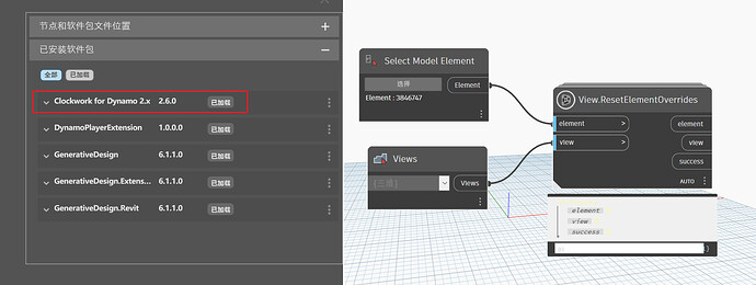

Hello @22112079 Clockwork and Genius Loci have some node for that “reset.element.override”
I tried it and the results were all null. May I know the possible reason for this?
Yeh do you have DynamoIronPython 2.7 version 2.5 installed ?
Skærmbillede 2024-02-27 120850
Do I also need DynamoIronPython 2.7 to try installing only the clockwork package?
The result is still null
Yes you will need install Dynamoironpython package 2.7 version 2.5, and i guess it will work
Thank you so much!!!It works perfect!!!
