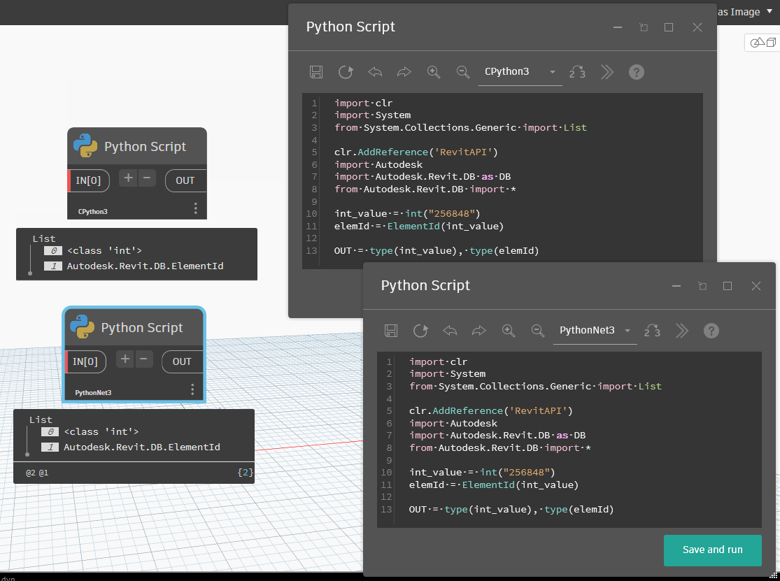

Yes, but python 3’s int treats all ints as long. So shouldn’t really be noticeable unless you are doing something odd.
True. But that is a double edged sword as Python 3 should be used both before and after the element ID change, which means you’re either getting ints converted to longs and working in the post element ID change or getting an error in the pre-change builds around receiving long but needing int32.
The world has sadly been made far more complex then it ought to be…
With some Python Built-in Types (int, str, ) there is a conversion/cast which is done automatically according to the type of the parameter of the .Net method or constructor.
