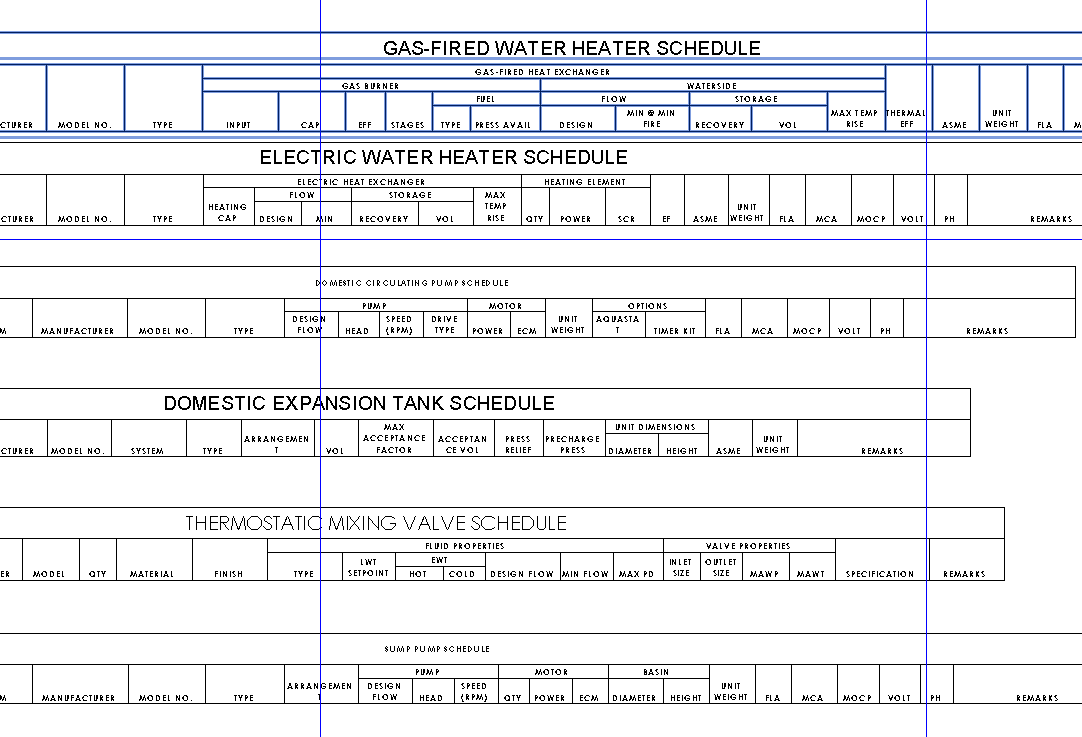

Reset Schedule Title and Heading Fonts

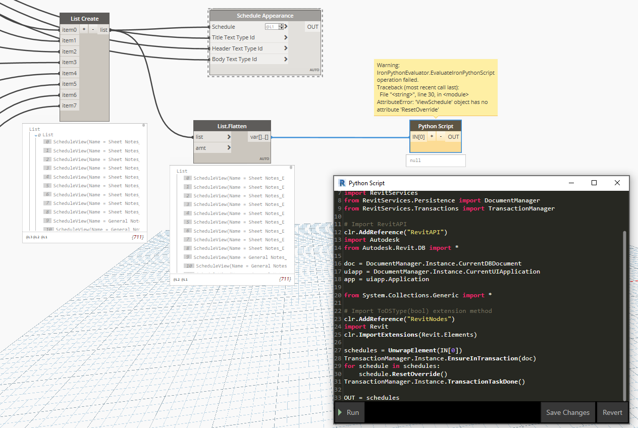

Is anyone aware of a method for resetting the title and heading fields of schedules?
I haven’t been able to locate a node to do this, but assume Python could be used, although I’m not proficient at all and this is as far as I have got:
The error implies that you are providing a list of schedules rather than a single schedule. In that case, you would write something like this:
schedules = UnwrapElement(IN[0])
for schedule in schedules:
    schedule.ResetOverride()
@cgartland, thank you for the response! I tried your recommendation and still get an error.
    schedule_def = schedule.Definition
    # get schedule field
    schedule_field.ResetOverride()
The process seems to be a bit more complicated. I can’t test this myself, but you will have to get each of the schedule fields in each schedule definition and use the ResetOverride method on each of those. The ScheduleDefinition class has a GetField method which accepts an integer, but does not appear to have a “GetFields” method, so the process of getting all fields is unclear.

How about a python way to add/change the bottom line style of the schedule title cell?
I’ve tried @Konrad_K_Sobon’s archi-lab “cell style settings” and “schedule tile appearance” nodes, but can’t get it to do this. I can get the node to change the the font, font size, bold, italic, underline, etc…but once I enter the line type for a border the node result becomes ‘null’.
Is it possible the API has changed so this aspect of the node no longer works? I’m working in Revit 2019.2 & Dynamo 2.0.3.
