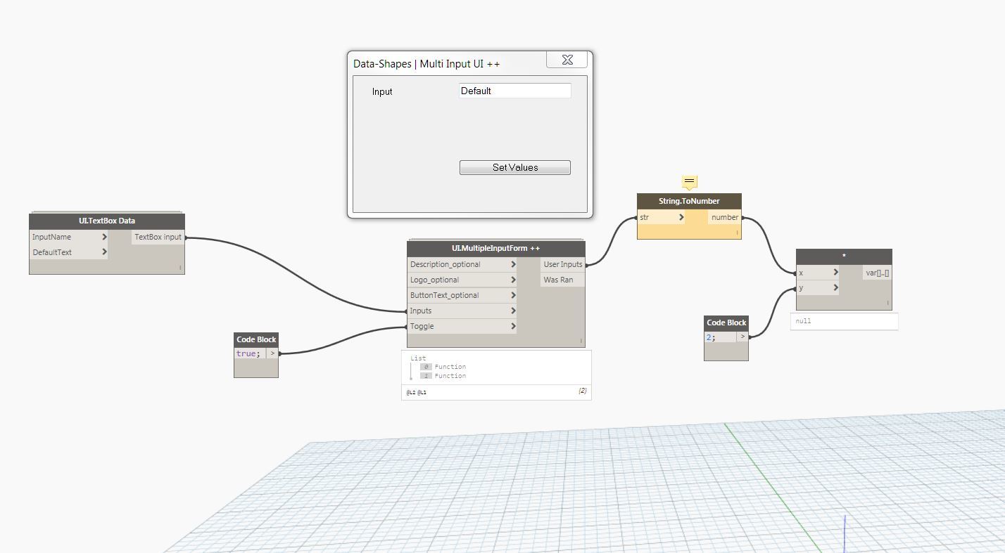

this what I am looking to do I am using Data-shapes package, multipleinput node as you see in the picture, so the idea that after put the input and hit the button the graph will execute then show the form again rdy for the next inputs. because I don’t know if the ForceEvaluation node will do the required :smile:, wt you think ?. athank you
@Mohammad_Nawar
place this node
this will activate the periodic Run and you can feed the time in ms as shown below
now you can periodically make dynamo re-run after the time you specify.
Man thank u so much, i will try it and let u know, :+1:t2::+1:t2::+1:t2::+1:t2:
