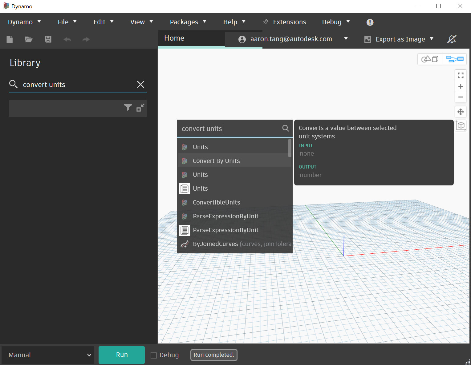

A huge thank you to everyone who has passed in failing cases here, we are happy to report that with initial work we have solved all of the Dynamo core failures by implementing Lucene and indexing heavily into… search indexing :nerd_face:
Apache Lucene is a high-performance, full-featured text search engine library written in Java.
A handful of such successes show below with implementation in the right-click only search and failures currently in the Library search. Ongoing work will unify both and improve across the board :slight_smile:
Convert Units
String from Object
Coordinate System Origin
Curve Trim
List Join
Sneak peek of also seeing a mock-up of ability to search for Documentation in this search also (Such as Extended Node Help and Sample Files), referenced by the jarring icons :wink:
