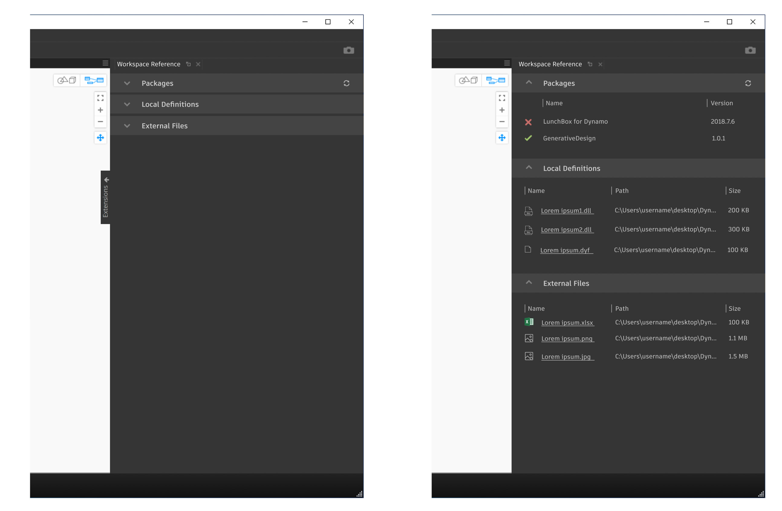

We are going to make improvements to the Workspace References extension over the next quarter, enabling you to not only see installed or missing package content and resolve it, but also understand what else your Dynamo graph requires to run on someone else’s machine.
This means local things such as Excel files, CSV files, images, DWG’s etc., and also local Dynamo nodes such as Custom Nodes (.DYF) and local ZeroTouch nodes.
But… we have a problem! We want to know if our three category names make sense :smiley: Below we have a UX design mock-up of what we are thinking:
Workspace References Category Names
  • The category titles make sense to me
  • The category titles do not make sense to me
  • I think I can do better - and am putting my suggestion in this thread

The category titles make sense, but I had a question.
For the local definitions portion- will that surface packages that are not found on the package manager or installed by other means?
This is the plan, yes! :smiley: For example, local .DYF files, or ZeroTouch nodes that you have on your machine and loaded into the Dynamo space.
Could we see the path for loaded Packages as well?
For those of us that develop and distribute graphs for internal use, we often have additional packages loaded for testing. It would be nice to confirm that the packages in my graph are all coming from a public location and not my local testing folder.
Good suggestion Nick :slight_smile: We can wrap that in as well.

Good idea in general, I am not so sure about the naming:
  • Workspace References, it feels like Autocad :wink: . End of the day the workspace is a dynamo definition or a script. Nobody calls it a workspace. We share Dynamo Graphs, Dynamo Files, Dynamo Definitions, not workspaces. I’d rather go with something like Graph References
  • Packages, fine, same language as in the rest of the UI, External Packages,
  • Local Definitions, not sure about that one. It could be: A custom node or local zero touch nome, but also a local zero touch set of node therefore a package. Why not Local Packages, that makes it more inclusive imho
  • External files in this context does not make sense to me either, what can I do :roll_eyes: . They are external to the dynamo environnent, I get it, but they probably are local resources that are missing (or not). Extra files , they are not dynamo related and we do not qualify them as external as opposed to internal.

True. But adding a package is modifying your core Dynamo workspace - new nodes are added to the library.
You are right @jacob.small . I think a visual graph would help structure the terminology :slight_smile:
Hello @Jean-Marc - thank you for your 2 cents :slight_smile:
On the whole great suggestions - here’s a few comments:
  1. Workspace References is the name of the overall extension that was released in previous versions of Dynamo. Understood that it feels a little AutoCAD-y, but it also thematically fits the notion of where you work inside of Dynamo. To rename to Graph References we would have to trade-off the existing cost of how users see, use, discuss and understand it today versus a renamed state.
  2. The reason we have Packages vs. Local Definitions is that locally you don’t need to have created a package and can have floating DYF files. Any content on the Package Manager is by it’s very definition a Package. Either way we’re a not fully capturing the state of play in a single title - it’s either a local package or local loose DYF files and neither name matches fully. Bit of being between a rock and a hard place on both these names unfortunately.
  3. External Files is a common pattern in software, speaking as you note to content external to Dynamo itself.
