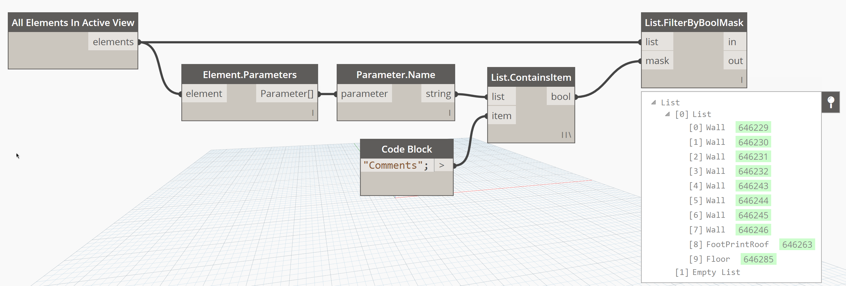

Thanks John, I found that a little while after I posted this actually but I can’t get it to work, despite trying multiple lacing options

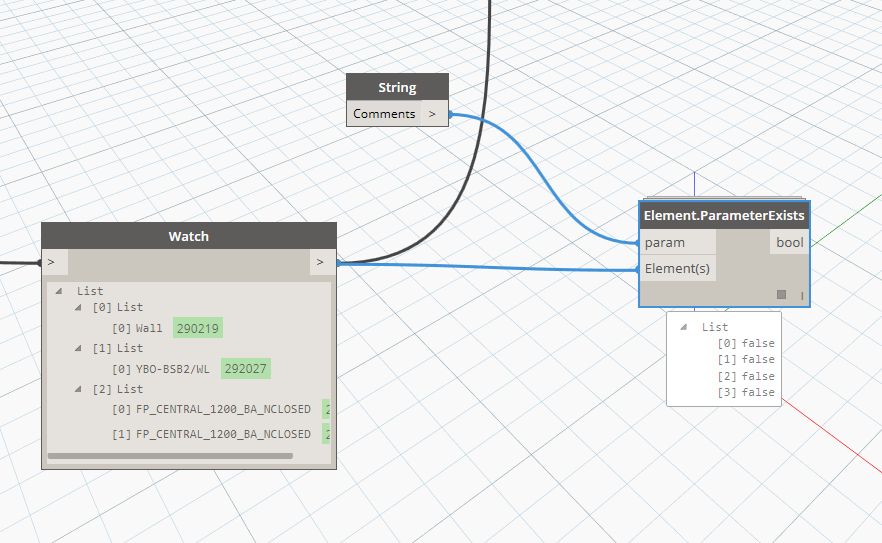

Even when I put in a parameter name that I know I have, it returns everything as false. Any ideas?
Revit and Dynamo version?
Revit 2016
Dynamo 0.8.1.1942

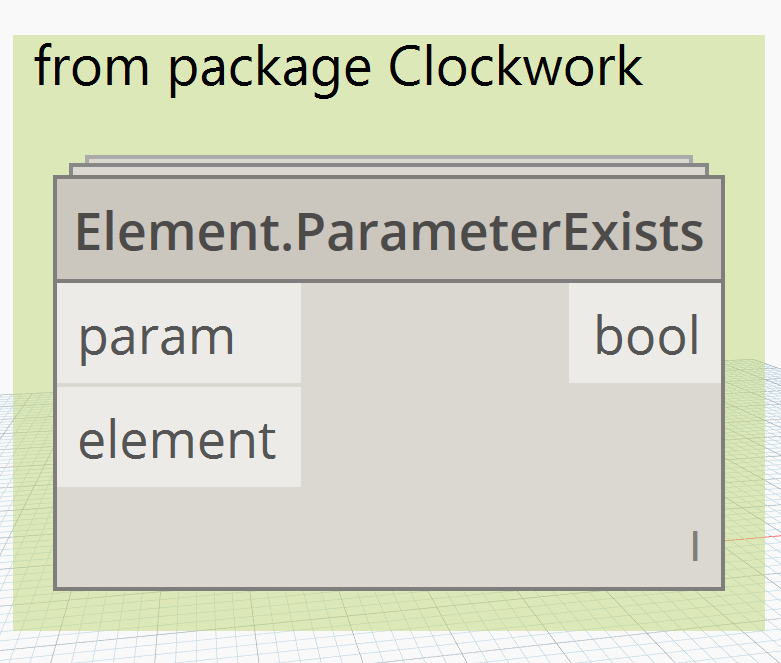

This should do it.
Rob-

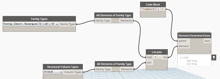

Interesting. When I try it with the below it works. Care to share your full DYN?
Thanks John, your method worked perfectly.
Tom, yes, colleagues got it working with the same method I did as well. Unfortunately no matter what I tried it wouldn’t work for me. It’s probably a local installation glitch or something. Sadly I can’t post the DYN for company privacy reasons. Thank you for your help!
I have noticed that nodes can sometimes become glitched. When I feel they should work but do not deleting them and grabbing a new one works. Not sure if you tried or not but for future use.
