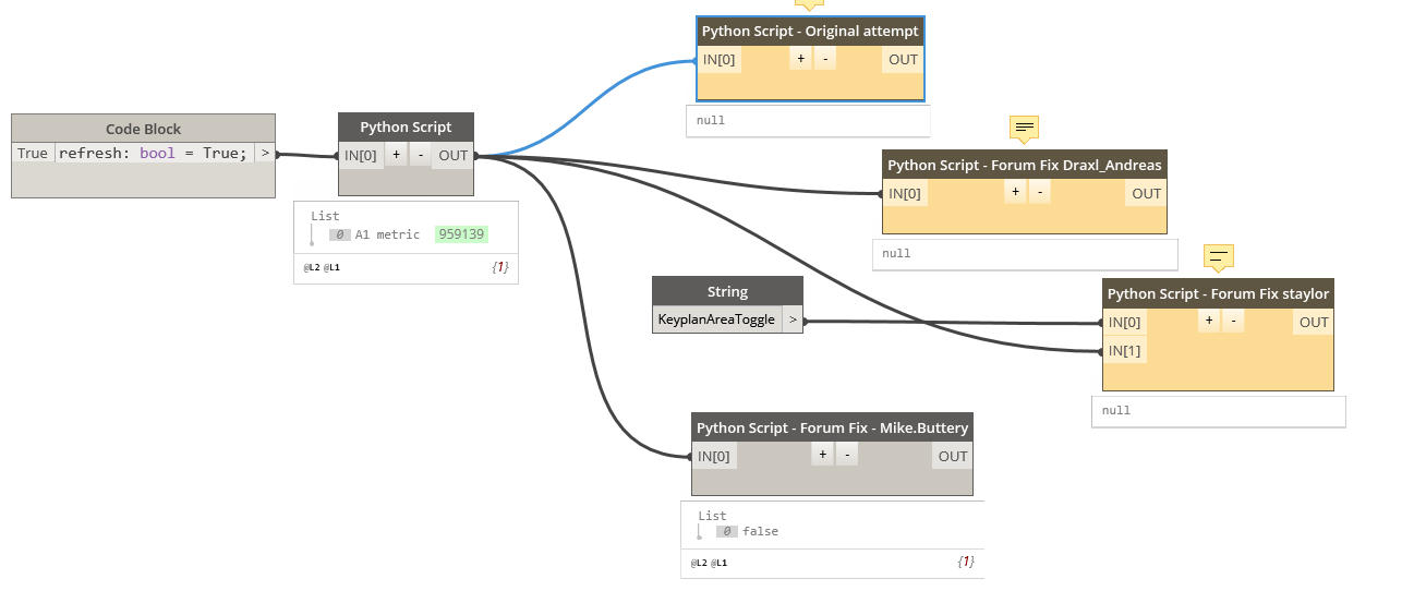

I wanted to let you see my results:
@Draxl_Andreas , It gave a null output and the message - Warning: IronPythonEvaluator.EvaluateIronPythonScript operation failed.
File “”, line 29, in
File “”, line 15, in parameter_exists
AttributeError: ‘List[object]’ object has no attribute ‘FamilyManager’
@staylor , It gave a null output and the message - Warning: IronPythonEvaluator.EvaluateIronPythonScript operation failed.
File “”, line 14, in
AttributeError: ‘List[object]’ object has no attribute ‘GetTypeId’
