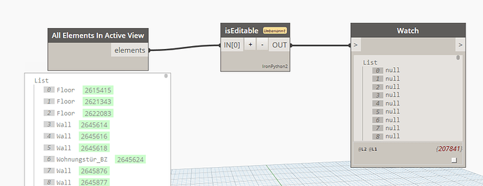

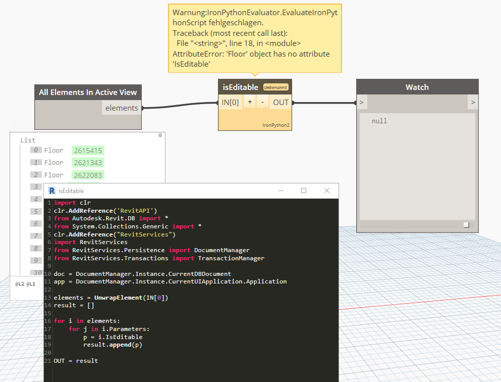

How can i ask, wether the parameter exists?
Hello Dynos,
I want to distinguesh editable and system families
clr.AddReference('RevitAPI')
import RevitServices
app = DocumentManager.Instance.CurrentUIApplication.Application
elements = UnwrapElement(IN[0])
result = []
for i in elements:
	for j in i.Parameters:
		p = i.LookupParameter("IsEditable")
		result.append(p)
OUT = result
My code runs pretty well… but without result.
How do i “look” wether a parameter exists in an instance?
KR
Andreas

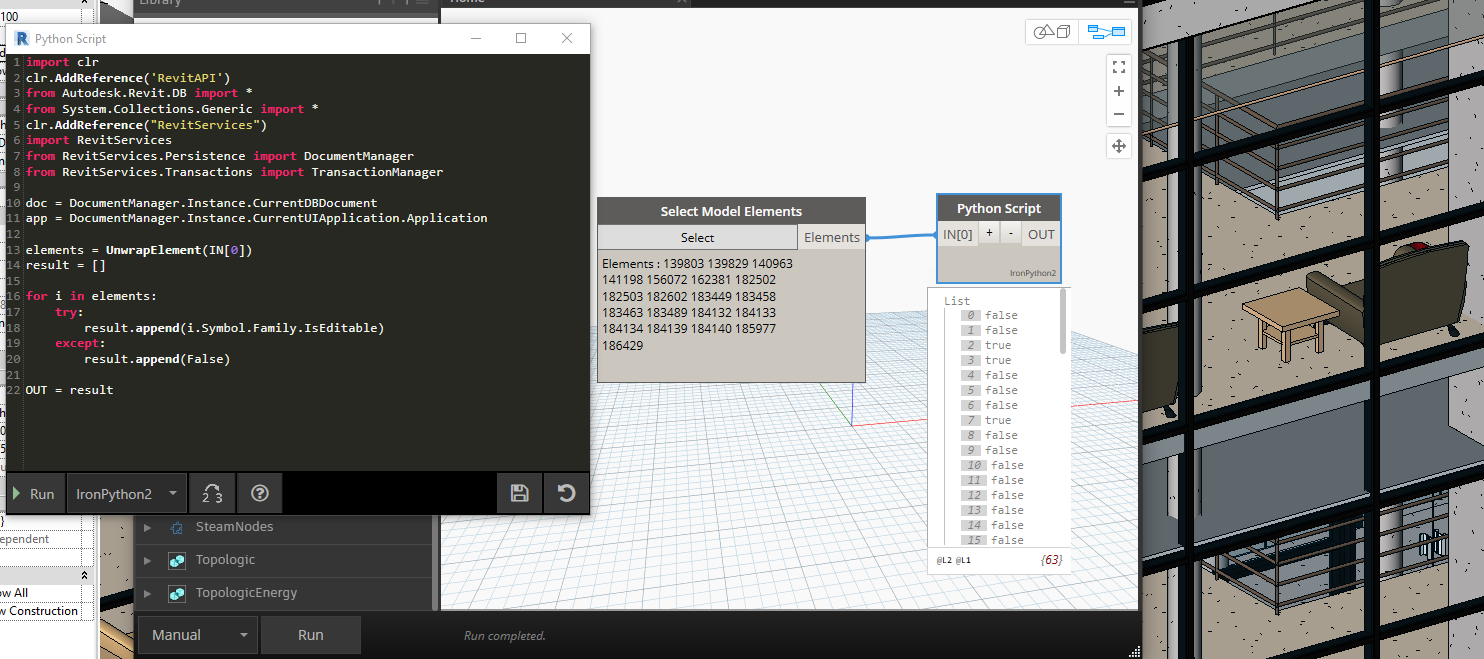

@SpenceOJAS ,
thanks… how can i set it with a boolean?
so f.e. systemfamilies does not have this stuff!
i want to filter editable and not editable families!

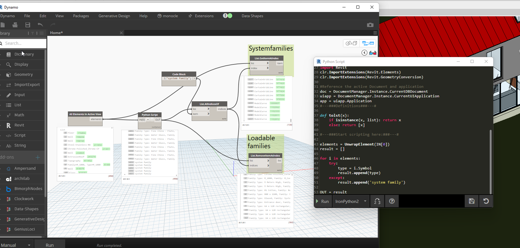

How about this, @Draxl_Andreas:
result = []
for i in elements:
	try:
		type = i.Symbol
		result.append(type)
	except:
		result.append('system family')
OUT = result
