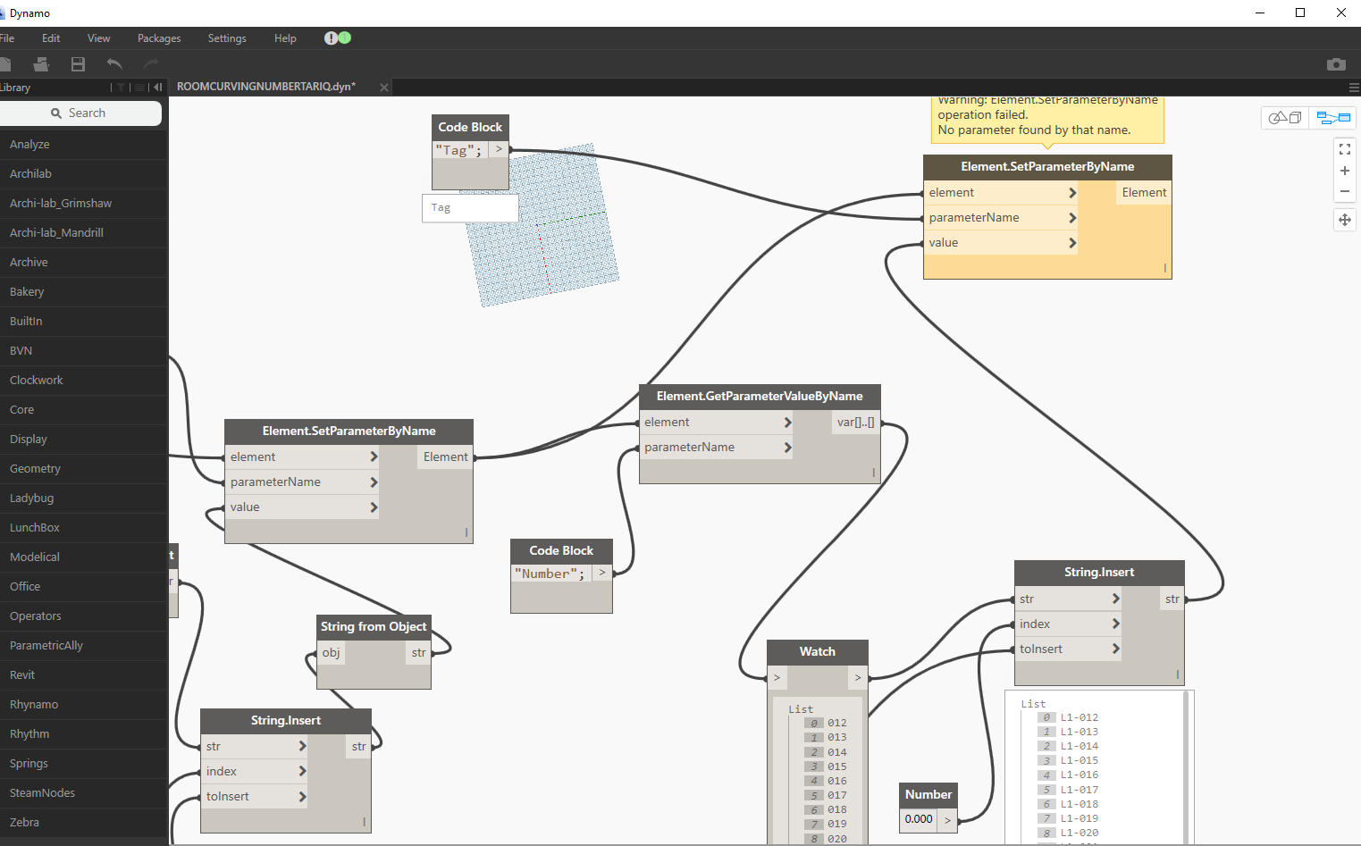

I was tinkering with the renumbering of the room numbers with this file ROOMCURVINGNUMBERTARIQ.dyn (26.6 KB)
the error message that I am receiving is in the below snapshot -
My room numbers are coming up as 12, 13… instead of L1-012, L1-013…
Can someone help.

Your definition works for me, however you don’t need this:
In the group is what I think a better way to create the room numbers if they reach a 3 digits number

I have now warning messages now.
However my output in room tags in revit still shows them as 012 instead of L1-012.
Is there something that I am missing?
Attaching the experiment revit file room image here -
Did you see the bottom 2 screenshots? You have to change your definition a little bit before the Elemenet.SetParameterByName node.
missed it…thanks a lot. :slight_smile:
