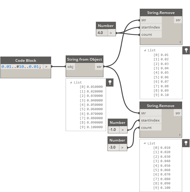

I create dynamo script for renumbering room.
But after convert to revit, room number show 6 trialings numbers after dot. I need only last two numbers. Do you know someone a solution of this problem.

The String from Object node is causing that issue
You could manipulate the string before using it to set the parameter value.
It works great!!
Thank you so much for your help.

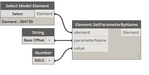

In this example you changing number to string and we can not use Units in Revit. Can we achieve the same with Numbers?
Whether or not you can use numbers depends on the parameter you’re trying to set.
