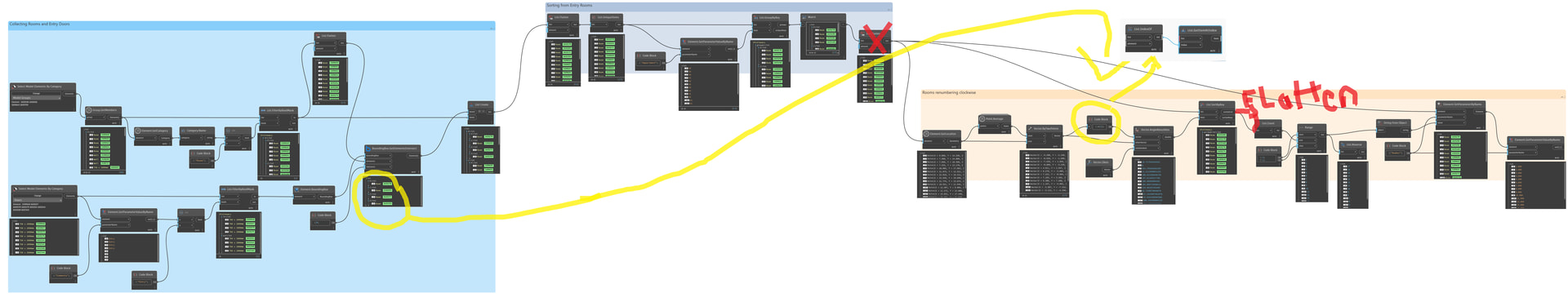

Thank you Christian. Sorry but unfortunately I can’t see from low picture resolution two nodes that you add above. Can you just write it which ones are they? Thanks
Damir
Indexof et getitematindex
I would go more in this direction:
when you have the pieces with doors, I sort them according to their angular value, using your desired first door as a starting point,
and then I send this to a Python node. If my door is A1, I send all the pieces with A1, and so on. Once I’ve sorted them into sublists,
I flatten and then number them.
I’ll try to do an example tomorrow around the same time if this message is unclear.
Regards, Christian Stan.

I don’t know if this worked as I said yesterday, here it is:
I didn’t use Bimorph, I don’t have
(a little shortcut to put yourself in the same conditions as you when starting your script)

25_11_10 rep pieces reoorder.dyn (52.7 KB)
Regards, christian.stan
Thank you @christian.stan very, very much. Everything works.
