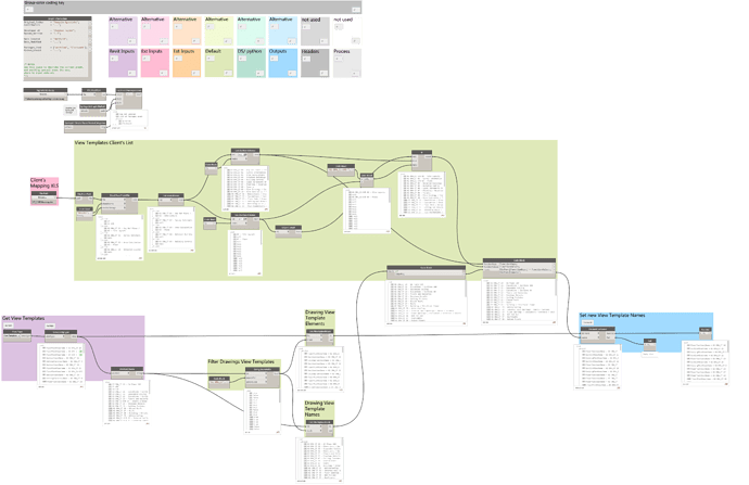

Was trying to create a graph that allowed to quickly convert the existing company View Template list into using other drawing category codes given by the client.
I was trying this last step with Clockwork Element.SetName node, as suggested here, but the View Template names remain unchanged.

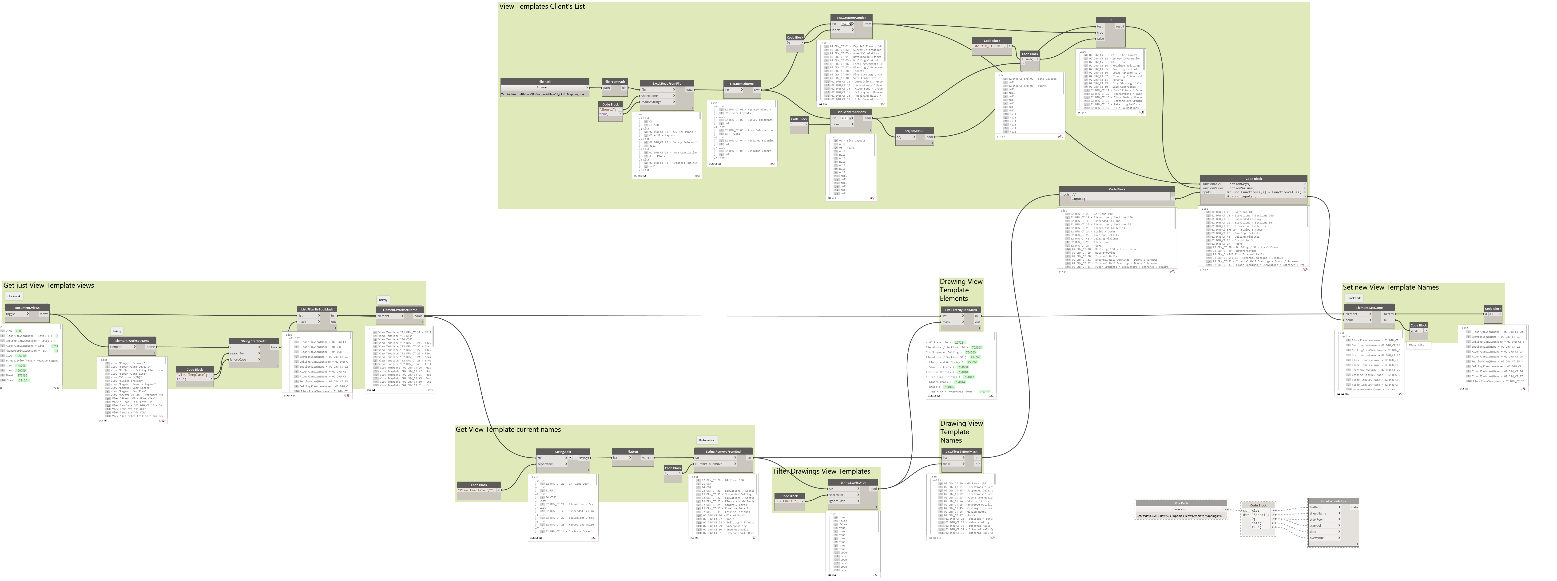

Like the post you reference, I would start by trying one template to make sure your element.setname node is working. Second, I would use View.IsTemplate for your initial filtering to get view templates through the BoolMask.

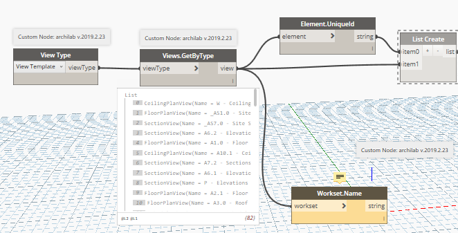

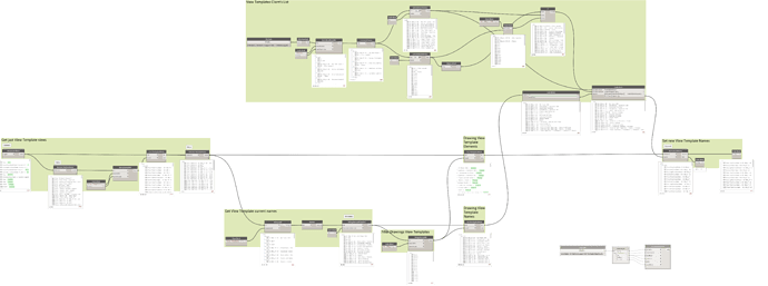

I’m trying to Export to Excel so I can use formulas for renaming there, but the “Workset.Name” (archilad) node isn’t working in Dynamo 2.0.3. I was successful exporting as shown here, but as the List is shown which can’t be used to bring back in…
…but I get this warning from Workset.Name…
“Warning: Workset.Name expects argument type(s) (archilab.Revit.Elements.Workset), but was called with (Revit.Elements.Views.View).”
Any help making it work with the right Nodes (Workset.Name) ro get VT Names to Export to Excel properly?
