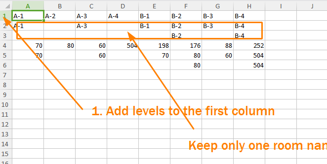

Since then I have searched for some more options in the forum. Based on this I have been able to reach to this point. Refer Attached .dyn , excel and screenshot. I just need help to get levels in the first row and only one header for the areas. Request some magic touch from you guyes. Thanks in advance.

The structure of your list create wasn’t quite right, you had the name and area as a sub-list, I’ve just even’d it out…
With the ‘only one room name’… it could be that you haven’t deleted your excel file from a previous run… each export from dynamo only updates the cells you have told it too, so if you don’t delete the old excel you get historical data left over from previous runs…

Thanks for this. Unfortunately it is not working the way I want. Please find attached the screenshot of revit schedule and excel result I am attempting to have. Hope that clarifies the intent.new.xlsx (10.2 KB)
