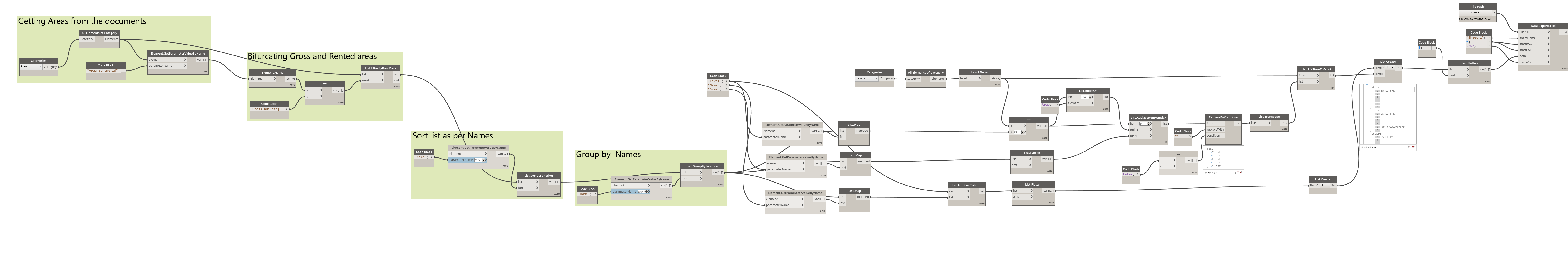

Area Statement export to Excel-other aproach-MKA-3.dyn (80.7 KB)

You should drag the List.Replace node from the library and erase the List.Replace node contained in the graph.
The “unresolved” error is probably there because of 2 different versions of the Orchid package.

Area Statement export to Excel-other aproach-MKA-3-NODES REPLACED.dyn (80.7 KB)

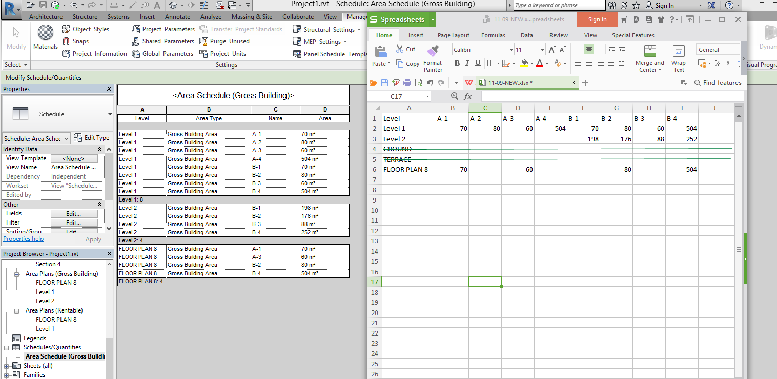

@Mark.Ackerley To some extent this is working, but not entirely. I am attaching excel, modified .dyn (those two nodes replaced) and screenshot showing the difference between schedule and excel. Thanks a lot for efforts.

Area Statement export to Excel-other aproach-MKA-4.dyn (87.1 KB)

Only some tweaking is required.
- The floors where there is no area need not come in schedule.
- When there are multiple areas of same name… they are not adding up.

(Shuts eyes) Area Statement export to Excel-other aproach-MKA-5.dyn (98.4 KB)
