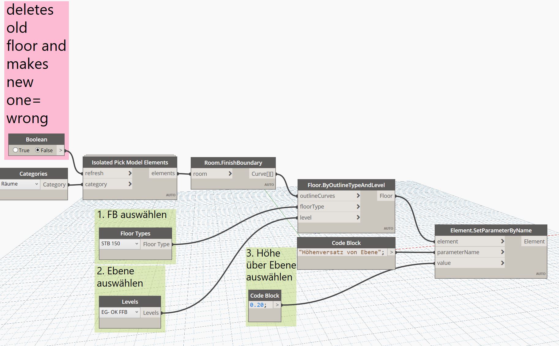

So my script make floors from rooms, i can set the floor type, level and height above level… by picking the rooms, that works great.
BUT, i have to close the dynamo file and reopen it to use it again with other rooms, because i can’t make a new selection…
tried boolean, but that delets the floor from before…so not an option or i used it wrong…
anyone has a solution for that? :smiley:

Well my dynamo player says that there are no settings to change, but i obviously can change them in the graph…were is the fault there?
Set the parts which need to change to have ‘is input’ status.

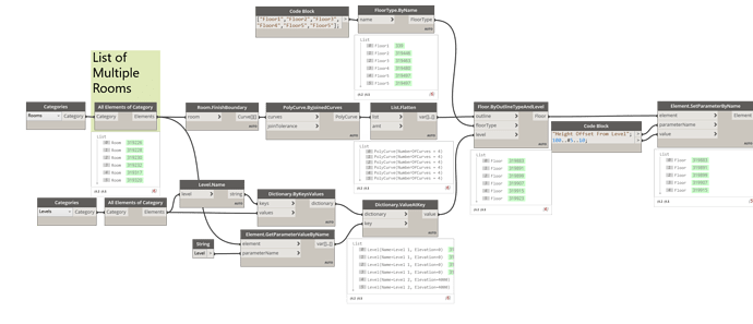

There is, if you create the floors for all rooms at once.
You can create a list of selected rooms (by selecting multiple elements or other methods of short listing based on outlined criteria)
As shown in the graph below, you could prepare a list of rooms, levels and floor types and create them at once.
RoomFloor.dyn (38.3 KB)
Hope this works for you.
